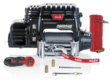

As partial as I am to the DOI winch bumper, I am in love with this setup:

9.5ti Thermometric 9,500lbs
or the PowerPlant HP with an air compressor
Warns site
http://www.warn.com/truck/index.shtml

The Warn Power Plant weighs 100lbs and the 9500 weighs 89lbs.

I'm thinking that powerplant would be a pretty sexy thing to have in an integrated style winch bumper??

Only thing I would say to look out for with the PowerPlant HP on a Hummer H3 front end is how much airflow does it prevent from reaching the radiator. It appears to stick up pretty high and could block some needed air into the radiator, causing the vehicle to run warm; in the desert areas.
