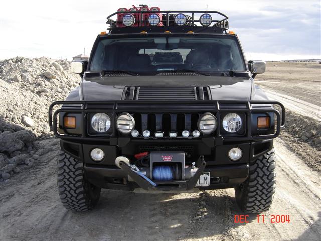

Old 01-15-2005, 01:25 PM
RIC-H0's Avatar
RIC-H0 RIC-H0 is offline
Posts: 2,605
I prefer the multimount over the fixed because of the flexibility from front to rear, and taking it with me, on other vehicles when I'm not in my H2. ie. My buddies 2500HD has the connectors for the winch, but has no winch yet.
It's easiest for me, but some prefer the fixed mount for the security and a little more stable.
I think it's all a matter of opinion!

Old 01-15-2005, 04:40 PM
RIC-H0's Avatar
Posts: 2,605
I've yet to have mine stolen, but if someone were to really want it, they could break the pin lock and take it off the front of my vehicle.
As far as Stability goes...with the multi-mount, the whole winch is resting on the receiver, and not mounted to the frame. I have exceeded the limits on the capacity of my winch a time or 2, but the whole time, I wasn't concern with the winch giving way as much as the receiver mount bolts breaking on me.
Just my 2 cents worth!
But I will continue to use my multimount!
I actually leave my winch on 100% of the time, because you never know when you may need it.
It's kinda like steel toes on a workboot, kinda inconvenient at times, but really nice to have when something causes you to need them!

Old 01-18-2005, 04:46 AM
RIC-H0's Avatar
Posts: 2,605
I normally don't have the front plate on mine, even though per state law it is required.(Great! I'm probably going to get a ticket now!)
The neatest way to mount your plate is, to bolt 2 pair of mag light mounting brackets to your plate(2 on top & 2 on bottom of plate), and then simply attach the plate to your roller fairlead. You can take your plate off and on as needed, and it keeps your fairlead nice and bug free at the same time!
