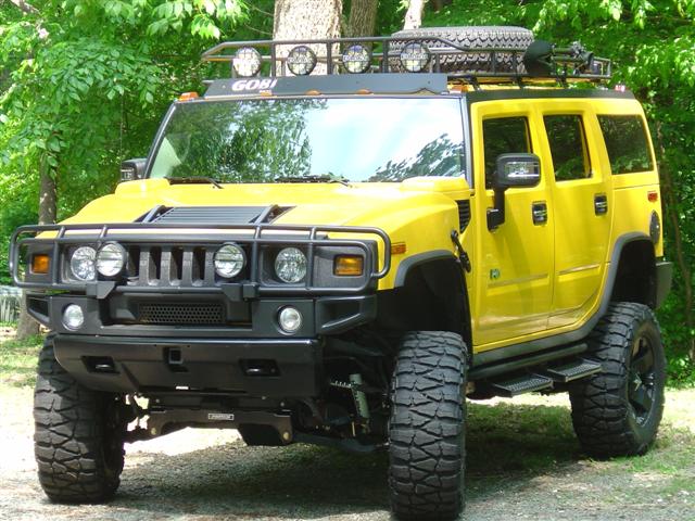

thanks for the help.. i went with 37 x 13.50 x 20 nitto mudd grapplers. yes the sway bars are attached.. but maybe i need heavy duty ones.. what do you suggest.? i just went with the fabtech shocks that came with the kit. so maybe the dual shock setup would help with that. ive also seen a dual steering stablizer, but im not sure if that would help...heres a pic thanks !

nice looking rig. I concur with the prior comments. Also you must figure that if you are raising your center of gravity, you will tend to get more body roll.

NICE RIG! THe steering stabilzer is worth the money..esp. if you are going to off road the truck. It will not help with your issue, but it will make input to the steering much better.
Edelbrock trailering arms and sway bars and panhard rod would be your next trial of mods. Phil D had these on his H2. He also had the fabtech kit. You may want to send him a PM to see how he liked them.
