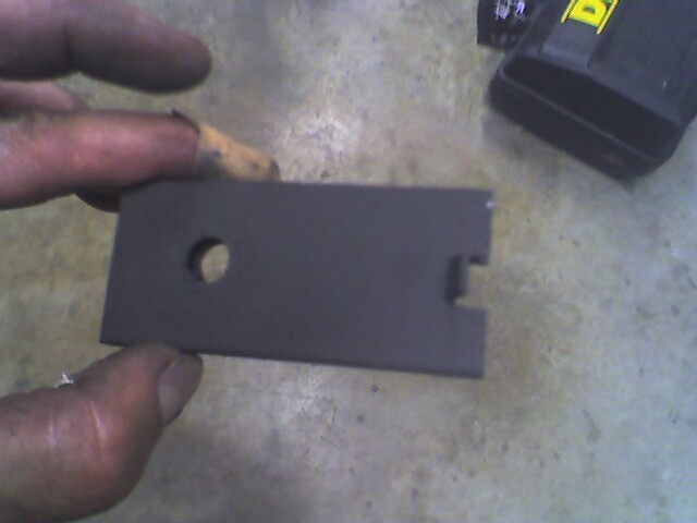

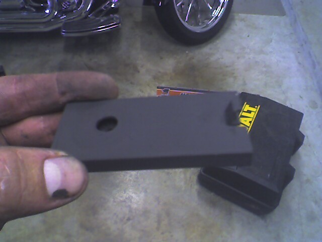

On my H2, I used stock length shocks and shock extensions. This made it a necessity for me to extend my bump stops as I would now bottom out on the shocks harder than I would had the bump stops still been there to slow/stop the motion.
However, since I used shock extensions I was able to get away with using a spacer between my OEM bump stop & mount. Here is what I made to take up the 1/2" space between the control arm and bump stop:
