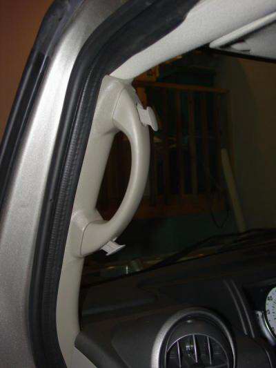

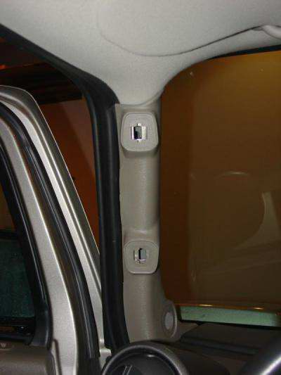

I am going to install a rocker switch into the overhead console to run my new PIAA 580's that I just ordered. I took the small overhead console (SUT - so 2 reading lamps, homelink, and sunroof switch) off and see where I can run the wires, but my question is this: it looks like I can go thru the headliner from the overhead console over to the A-Pillar, but how do I get the A-Pillar off to run the wires down to the fuse box? Do you just pop those little rubber things off of the handle to reveal some screws? Just making sure before I ruin a part.

The plugs on the handles are how you remove them. When you pull the plugs the handle comes right off and the A-pillar becomes loose.

Here is some pics

Wow! Major thanks for the pics. I hooked up the lights tonight to make sure that I wired everything correctly, and tomorrow I hope to finish the job by mounting a rocker switch in the overhead console using your directions. Thanks again for your help!!
