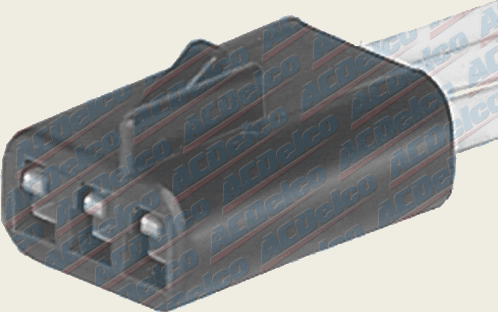

I am going to mount some off road light on my brush guard. I bought the factory dash mounted switches. $27 each only to find out the do not include the other end with the wires on it.They are another $35 each, I found them on line for $16.My question is what wire is what of the three as they come off the switch ? top, middle, bottom when installed.

the switches are #88963885 & #88963884 one has an arrow pointing up for roof lights and the other has an arrow pointing down for grill lights.The electrical connector with the wires is #12101864

TERMINAL A: Power wire to led to indicate that lights are on. Splices into the wire going from the relay to the lights.
TERMINAL B: Ground
TERMINAL C: Power

there are no markings on the switches I have

another forum said
A-GRD
B-ACC
C-12V+
