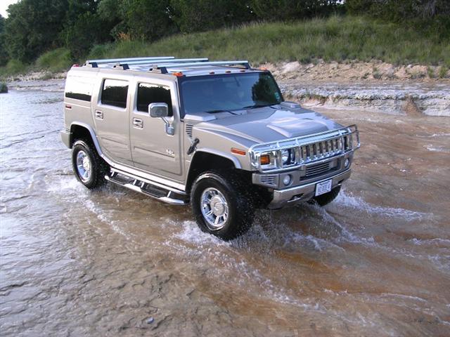

Found this (cubby's rig) here
\'05 SUT

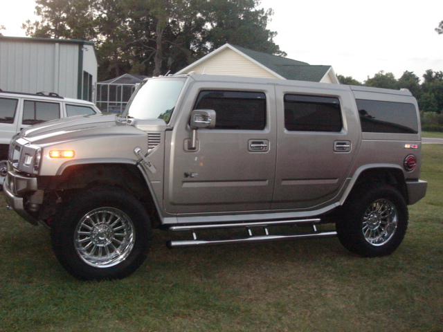

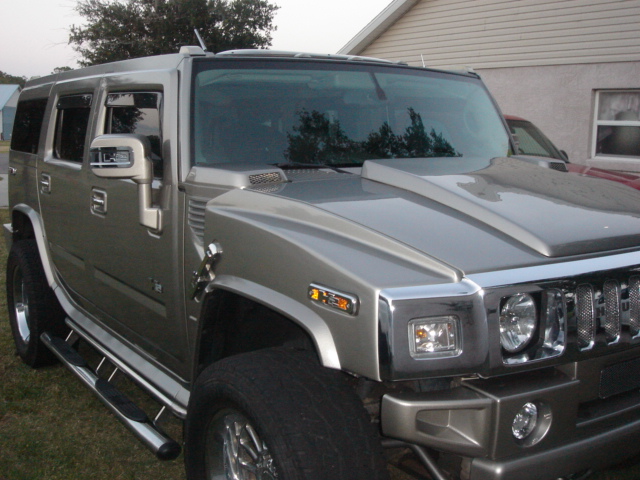

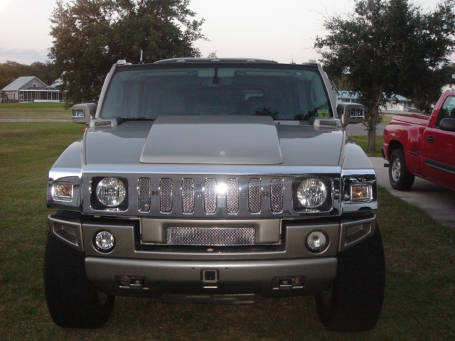

The parts can be painted if done the right way. Mine have been done for about 2 yrs and 65000 mile and have less chips than my hood.
