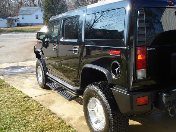

hey guys just thought i would post a couple of pics before i mod trying to decide which wheels i want i would like to go with 20 inch black rockstars but what tires can i use with the stock height

You can run 37's and have very minimal rubbing if any at all.

Nice......its always nice to see yet another black hummer....
If you want to get rid of those U-steps...let me know..

thanks alot guys i would like to maybe put some black 20 inch wheels with some nice offroad tires without a lift. what size rim width and tire would i need to make this work and look good but not to big for the stock height.

i have 20x10 black rockstars and 37x12.5 BFG Mudterrain km2's on my h2. I cranked the t bars a little and get very little rub. The km2's are great tires and seam to be pretty rare i think im the only guy in town who doesnt have nitto grapplers or toyos.

nice looking rig! What happened to the 2nd cross bar on the roof?

Jeez, I remember when mine looked that stock..Great lookin rig..Have fun with it..I have 37" Toyo M/T's with 22x12 wheels, t-bar cranked a bit to minimize rubbing..Hardly any at all..BRUTE

ya where is the other cross bar ???

the other cross bar was damaged so the dealer took it off

I would personally go with the 18x9 Rockstars and 37s at 12.5" width, if you plan on wheeling with it

tires will also be much cheaper if you go with an 18x9.
