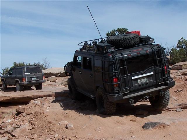

Won't it be hard to get to under the passenger seat?
Mine is mounted next to my right knee and there are abundant power sources. I use an open lead on the interior fuse panel. My antenna is a 4ft firestick mounted as high as possible and I would still like a better range. It does work fine on the trail.

Default Re: 08 H2 CB Install - HELP!
Originally Posted by HARDxCOR3
btw nice rig!!!
do have the firestik on a spring mount?
Yup. Tried it without one and i kept breaking the plastic grommet that keeps the antenna from grounding on the bracketry.

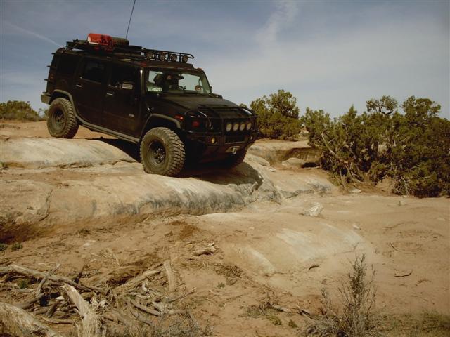

Front shot
