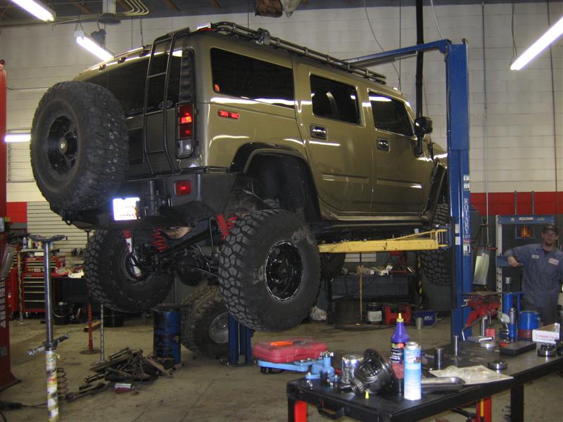

Well........ I've had the Eaton front locker for awhile and was waiting for the warranty to expire before installing it........ but I couldn't wait anymore so.......
New 4.88 Precision gears with the locker.

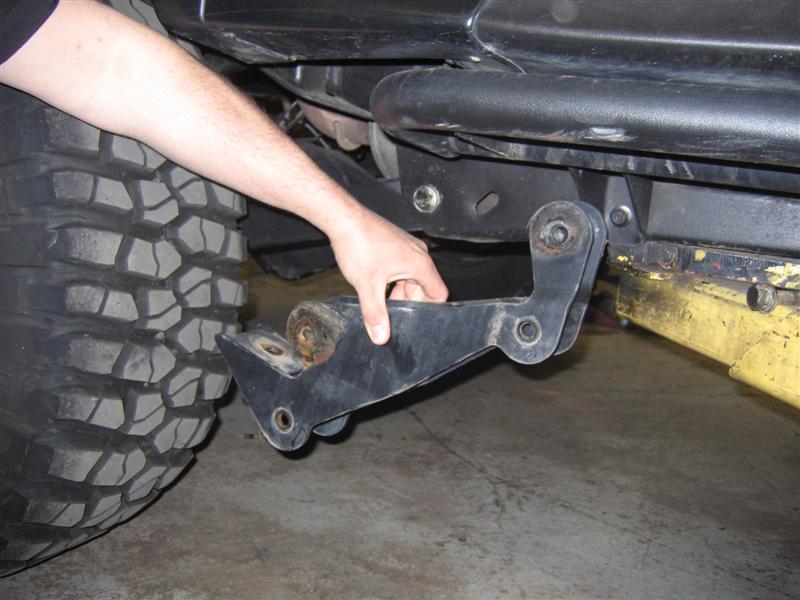

I also had the rear Rancho drop down brackets (for the control arms) removed. I hung up on those damn things more than any other part. Much better clearance back there now.
I'm having some new adjustable lower control arms fabbed up using tubes with a Heim/Johnny joint on the frame end and a bushing on the axle end. They are not finished yet so the stock arms went back into the factory mounting points. I have since found out that FabTech doesn't even use those rear drop brackets.

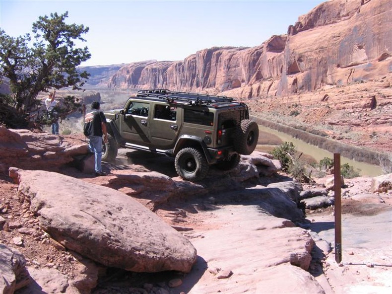

Pic is of Moab Rim (Z-Turn) couple months ago...... It is the reason for the drop bracket removal.....
Name:  IMG_1204 (Medium).JPG

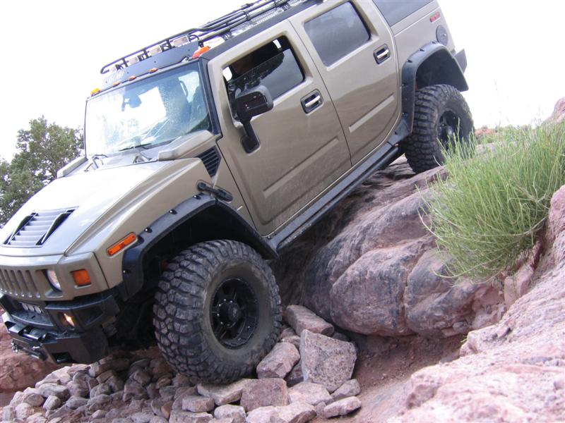

The "Fall" on Steel Bender..... same story
Name:  IMG_1449 (Medium).JPG

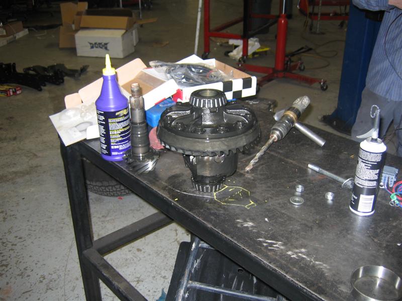

I kept the 4.10's (in the box) Hopefully I never need them again, but they looked perfect.
Name:  IMG_1594 (Medium).JPG

Well they cracked the case open and found the problem.
It turns out when they sealed the case with adhesive sealer it expanded into the oil channel to the pinion bearing........ without enough oil it seized.
The good news is that it didn't damage much....... The case is fine as is the locker, the ring gear is fine but the pinion is shot.
4 Wheel Parts has been good, they ordered a new ring and pinion and master install kit with the bearing and expedited shipping it in.
So far I'm happy with them.
Tomp I told them about the slack issue and they are on it.
