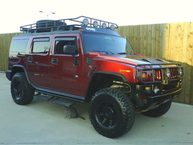

The cat in pic should take care of rats nest
Any chance they're talking about BCM(Body Control Module)? it's what gets the door open signals as well as many other things.
