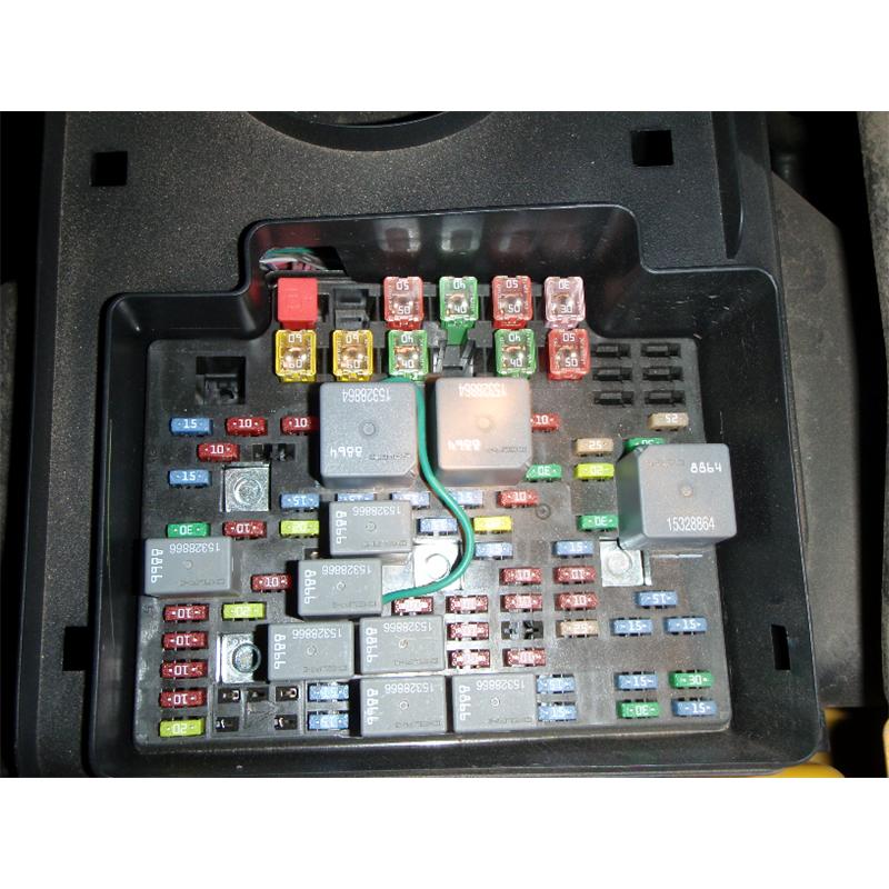

I just went through the old thread. I couldn;t find the one thread with pics of how it was done, but did find one thread with this pic.
Hope that helps somewhat. I'll be doing this mod again...once an SUT land in my garage again. I'll make a couple up and can send you one of you don;t get it handled by than...maybe a couple months yet.
for now, you an always just do the mod with the wire. I never did the diode setup, but did end up going through markerlight bulbs a couple times. I'm going to sue the diode this time so teh mraker lights stay off durring the day.

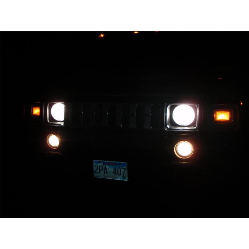

a few pics
Name:  no diode.jpg
