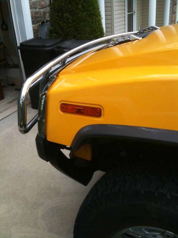

Hello,
The other night I had three lights all go out at the same time. They are the driver side: Rear park light [this light doubles as a brake light], rear red signal light, and yellow signal light. Note that all these lights are on the driver side of the H2.
I checked all the fuses and all fuses were good. I did find a wire shorted out on the frame that runs from the license light [from spare tire carrier] and is spliced into another wire that attached into a connector. The wire has since been fixed as to not short out any longer against the frame, however the three lights still do not work.
Has this happened to you before? Are there any modules that I can check that may be causing this issue?
[IMG]file:///Users/JMV1210/Library/Caches/TemporaryItems/moz-screenshot.png[/IMG]
Size:  107.0 KBName:  photo-2.jpg
Size:  115.2 KBName:  photo.jpg
