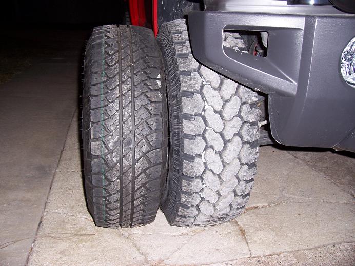

I have the stock H3 rims and bought the tires aftermarket. Heres a pic of the Bridgestone 33's next to my up-grades...Post some pics of your rig when you get it,, always like seeing shiny new paint..

StarsnBars how big are those tires?

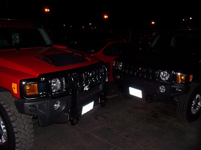

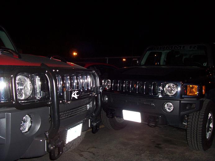

They are 315/75R/16 --- 34.7 or something like that. Just shy of a true 35 inch tire. Usually a T-bar adjustment is made by the owner Chaugar, not the dealer, per what info Ive read on these boards. Not saying they wont do it though. I had the 33's on in stock config with T-bars with no problem, but raised my T-bars 2-1/2 turns to give me alittle more room and level my rig our some. I dont believe dealerships offer 35's, for the H3, but I could be wrong. Its a aftermarket thing. Heres a couple more pics of what a T-bar increase with 35's verse 31's and no T-bar adjustment. Sorry about the low light shots. Hope this helps .. See ya,,,

one more,, top of hood approx 5 inches taller

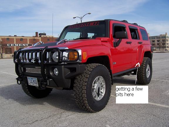

Yes they stick out further and my rear front part of fender is taking a beating. Ive been looking for some after market NICE fender flares like Bushwacker but havent found much. As for rubbing,, the tire just rubs the sway bar on full right steer lock, so as long as I dont crank it full right theres no problem. Average wheelin has been no problem but extream wheelin will probably get some tire hits. Not in to big a hurry to beat my new 35K rig so I havent done anything to crazy with it. See ya

Great pic !! I was looking at my truck after I reposted earlier. They really dont stick out that much more. 315/75R/16 Heres a pic

pits from what? offroading? or just everyday driving on the road? starsnbars - those tires looking totally awesome!

Thanks for the cudos gchurchill. The pitting is pretty much from daily use, although after my fishing trip <---excuse to go wheelin There was a couple new ones. I think its a problem area on the H3 even if you have the oreo cookie 31"s. I look at it as once they get pitted bad enough I might go for the X-Line product on all 4 fenders and grill.
