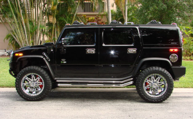

I'm running 37" Toyo M/t's with 22"x12" Moto Metal wheels and, yes, I did add Brembo Brakes. I never had a problem with the oem brakes and never any brake dust. The Brembo's do provide stopping power a lot easier than the oem brakes, especially with the bigger tires and wheels. However, since I do the car show circuit, I am constantly plagued by lots of brake dust and squealing from under 5mph. When I called Brembo, they told me to expect it since these are high performance pads..For what it's worth, I should have stayed with the oem brakes. I know I would have been happier, besides not having to spend all those $$$$$..They do, however look great and for a show car, that's what it's all about..An expensive lesson learned..BRUTE
That is one of the best looking H2's I have ever seen! Goood work. The brakes might not be worth the money, but DAMN they look GOOOOOOD!

Thanks Bro..I appreciate the positive feedback..Makes it all worthwhile..Got way to much money in it to part with it, so I guess I will keep driving it and polishing it..Keeps you in good shape..BRUTE
