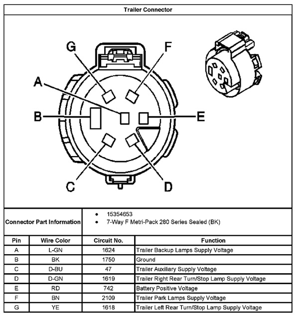

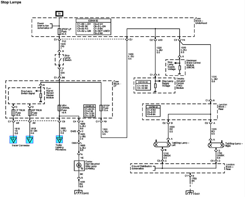

My service manual is at the shop...here's what I have from a repair cd.
Name:  trailer pinout.JPG

STOP LAMPS
The STOP LP 25 A fuse in the underhood fuse block supplies battery positive voltage to the normally open stop lamp switch. When the driver presses
the brake pedal, the switch contacts close and battery positive voltage is supplied to both the STOP 15 A fuse and the CHMSL 10 A fuse in the IP fuse
block, and to the turn signal switch. The turn signal/hazard module then supplies voltage to both of the trailer rear turn/stop lamp supply voltage
circuits. The voltage from the CHMSL 10 A fuse is to the center high mounted stop lamp (CHMSL) and the trailer jumper harness. The voltage from
the STOP 15 A fuse is to the stop lamps, throttle actuator control (TAC) module, and the electronic brake control module (EBCM). The CHMSL is
grounded at G410. The stop lamps are grounded at G401.
