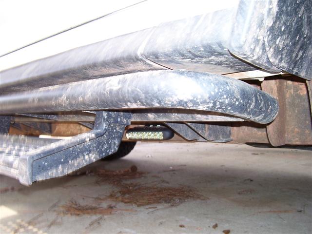

Phil told me he would break my arm if I didn't put some underbody lighting on my truck. Beastmaster said he would beat me up if I didn't install LED lighting. So, I did.
I got some LED fog lights off of Ebay. The housing was plastic chrome so I scuffed it up with some sandpaper and then painted them flat black so they wouldn't look like ghetto redneck engineering and just redneck engineering.
I put one in front of the rear wheel and one in the back of the front wheel on both sides. Mounted on the side of the frame up a few inches from the bottom of the frame. I'll see how long they last.

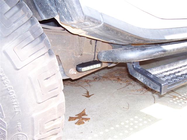

Picture of the rear ones:
03-02-2006, 06:05 PM
the front one

Actually, to answer your questions, the lights serve 2 purposes. One is that they act as puddle lamps at night and secondly and the main reason I added them is that when wheeling at night, you obviously have no light to the sides of your vehicle. With two of these on each side, it illuminates out to the side of the truck while wheeling very well.

Sure. Blame me for doing LED's. Your alternator will thank you!
The installation looks good. BTW, how much wire was attached to the lights?
1997.5 HMC4 Hummer H1 w/Slantback shell (Mine)
2006 Hummer H3 Adv. Package (Wife's)
M101A2 Trailer
03-03-2006, 03:00 AM
They come with maybe 10ft or so of lead wire. I ran the backs to the fronts and linked the POS from each to about a 16 or 14ga wire coming from the relay. Done same way on both sides. Grounds to the frame.
