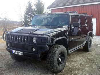

Included a pic the H2

Very nice, if you don't mind me asking, how availible are they becoming over there?
We have had just as many European members join lately as we have American, And from what I've seen around me, a search for local H2's has gone from 50 listings in 100 miles to a mere 3-4.

I guess maybe theres alot of buyers of the H2 in eastern europe. My car has been in Norway since 2004, like most of the H2s were imported in 2004-2005 to Norway. The cost of the H2 with all seats in the car were almost 250.000 dollars back then  They removed the back seats and put up a wall behind the front seats to lower taxes on the car, this is not possible anymore due to some new regulations so i dont think anyone is importing them anymore in Norway.
