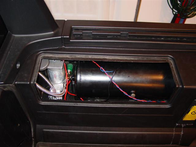

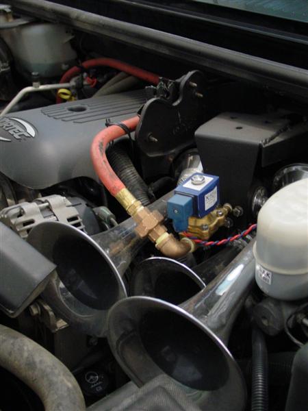

01-20-2006, 02:22 PM
Location: Cognito
Posts: 2,155
Few things - I made my own bracket for the horns by welding angle iron onto the existing bracket. You'll have to do something similar if you want them under the hood. It's a very tight fit but it can be done. Also, I have the compressor & tank mounted in the jack compartment in the bed. The jack is now under the back seat.
The the jack compartment you'll need to grind/cut off the jack mounts so the tank will fit. I had to cut some of the plastic between the compartment and where the accessory outlet is since the tank was long. The compressor power is tapped into the accessory outlet power.

01-22-2006, 08:39 PM
Location: Cognito
Posts: 2,155
Here ya go, here is the horn installation. If you want a compressor/tank pic let me know. It's pretty much self-explainatory though.

<BLOCKQUOTE class="ip-ubbcode-quote"><div class="ip-ubbcode-quote-title">quote:</div><div class="ip-ubbcode-quote-content">Originally posted by WhiteH2Kid:
can you post pics of where you put the compressor and tank as well please.. </div></BLOCKQUOTE>
Here is where the tank & compressor are. The pic is a little old, I have a different tank now. Same setup though.
01-23-2006, 01:03 PM
Posts: 1,260
Here ya go, here is the horn installation. If you want a compressor/tank pic let me know. It's pretty much self-explainatory though. </div></BLOCKQUOTE>
Man, that's tight in there under the hood. But it is out of view so it won't draw the attention of a LEO looking for any excuse to hassle you.
