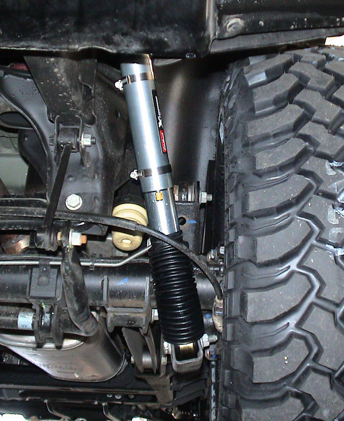

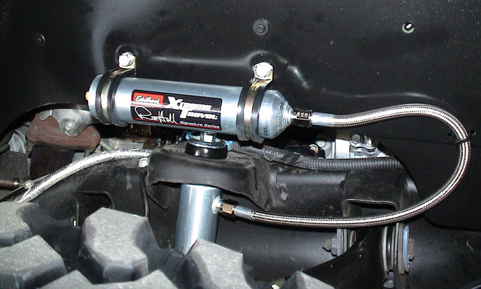

I've been thinking about upgrading my shocks. The stock ones are just not doing it for me. They're too mushy under hard braking.
I've been thinking about going with some Edelbrock Xtreme Travel Reservoir Shocks.
I've seen them on an H2 in the showroom, but haven't had a chance to ask any one for an opinion.

Old 10-07-2004, 02:24 PM
Rear shock.

Unless you just want the look of the extra reservoir, I would go with their regular IAS shocks. I have used those on several different vehicles and I really like them.
I have been told that the xtreme travel shocks won't offer any better performance that their standard IAS for the H2. If you don't have a lift kit and since we don't have great articulation, the extra travel and extra fluid is not needed.

I tried the IAS on my Tahoe. They were great on the road, but awful offroad. Way too much rebound over uneven surfaces. <HR></BLOCKQUOTE>I don't think there is much difference between the extreme travels and the regular IAS. I think they both use the same technology except the pistons on the extreme travel are thicker and, of course, you have the extra oil.
I've had them on F250, Expedition and a Jeep and thought they tamed everything well and didn't allow for sway on the highway. Personally, I think they stop the rebound extremely well compared to anything else I've had, even Rancho 9000s.
