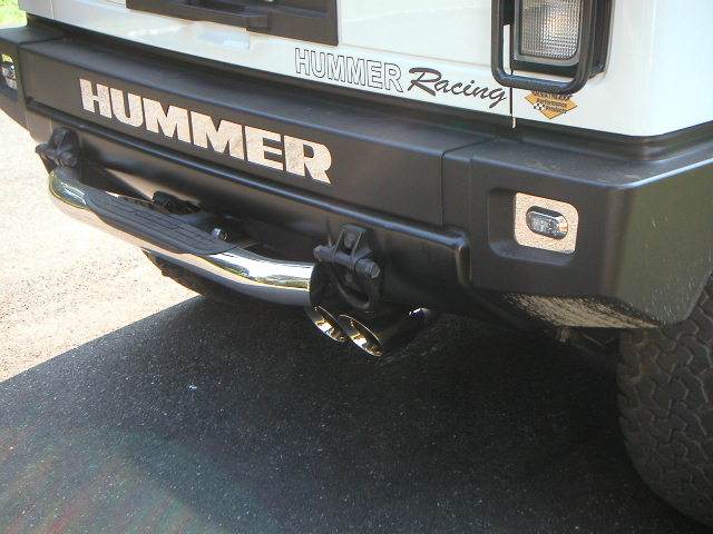

Went to dealership purchased corsa exhaust (touring edition) with the pro tips took it bach home yesterday to have a friend that owns a custom/muffler shop. they took the old one off with ease, then proceded to install the corsa. they were getting ready to take it off the lift when my friend said " looks like its going to hit the bumper and rattle the exhaust tip" so he took a torch and heated the back bracket to bend it down to clear the rear end when he heated the bracket a piece of hot metal came off and landed on the air line to the suspension burnt a hole in it and "whoosh" the rear end came down. so be carefull if you have air suspension (the line are very thin and not a standard size FIGURES.)

Where the installer thought there might be a problem was the tips were touching the black apron that runns along the bottom of the bumper , maybe my hangers were made on Friday or Monday at the Corsa production line but,It was an easy fix for them just a minor inconvience for me, GM sent the plastic $ 2.00 line the next day the shop picked it up installed and delivered my vehicle to my house by Lunch time. I love the sound its not to loud but not as loud as the Banks on the Diesel Truck. I'm very satisified and would recommend the exhaust for anyone. Hey beast sharp looking Hummer and advice on programmer,and air filter.
