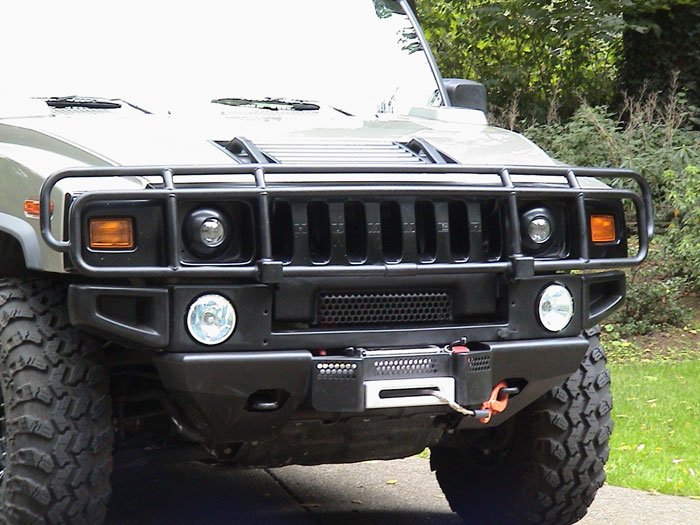

Old 03-14-2005, 12:04 AM
http://www.brightheadlights-hid.com/...Projectors.htm
</div></BLOCKQUOTE>
Those look exactly like the ones I put in my rig.
GREAT LIGHTS!!!! I paid $800 from my dealer(I was too lazy to shop around) and I put them in myself. I also ditched the (homoghey) chrome and had the bezels powder-coated black.

Old 03-14-2005, 12:19 AM
<BLOCKQUOTE class="ip-ubbcode-quote"><div class="ip-ubbcode-quote-title">quote:</div><div class="ip-ubbcode-quote-content">Originally posted by tower:
Looks nice.
BTW, DRTYFN,
When can I get a bumper from you? </div></BLOCKQUOTE>
That's the old prototype. This is the new one.Link
PM me. I'm just waiting for the synthetic rope to show up.

Old 03-14-2005, 07:24 PM
DRTY, did you have to modify the light buckets?
Were they plug-and-play?
