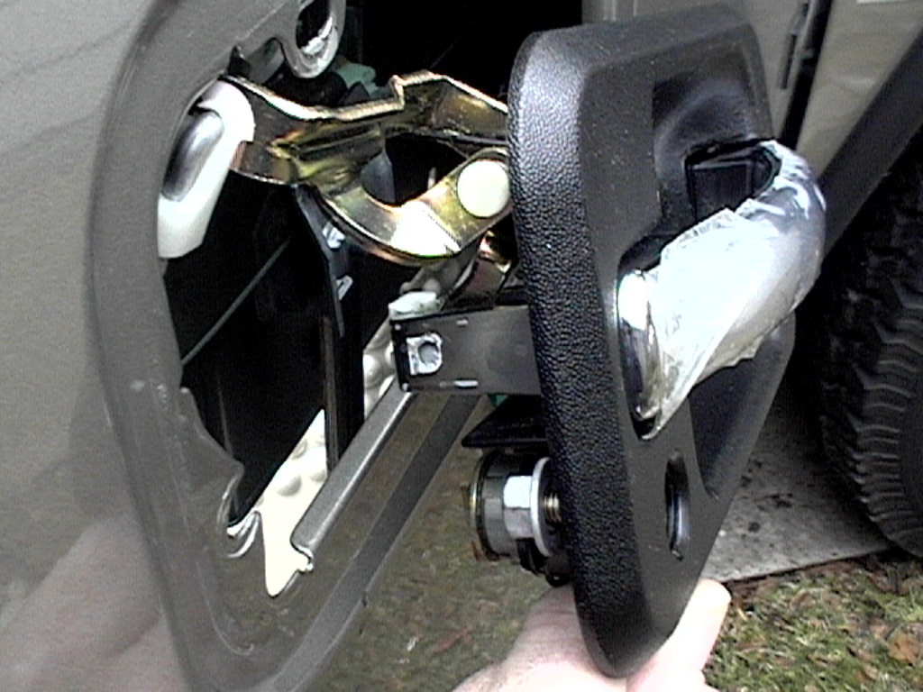

Alright, here are some pics and info.

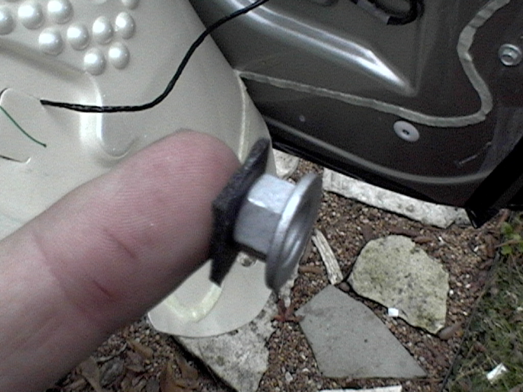

More pics

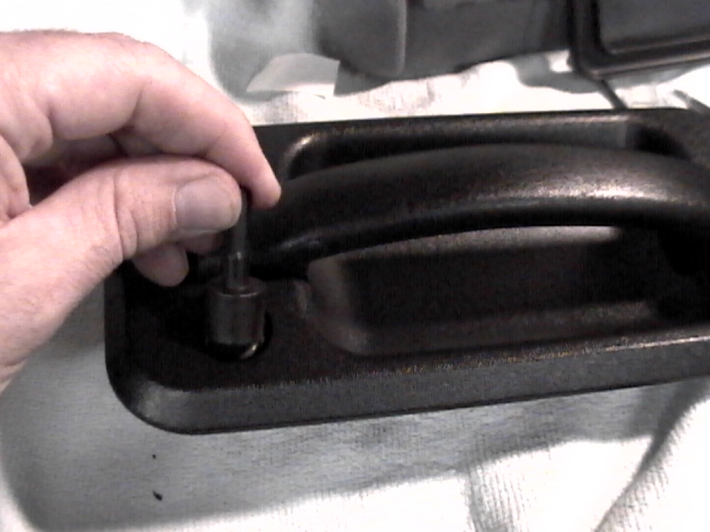

More

More

Alright, see the pics above.
To remove the front handles you'll need the following:
10 mm offset box wrench with end cut-ouff
10 mm socket on a 1/4" drive ratchet (smaller the better)
Doublesided tape - Get the stuff they use to install mirrors (at Home depot, lowes)
Facing the door, interior side:
there are 3 studs securing the handle bucket.
The nuts on the left side, and on the upper side can be removed by using the cut-off wrench pictured. This is a tight squeeze but you manuever the wrench between the door skin and the window.
The nut on the right side can be removed with the ratchet. It is tight fit, but the ratchet will fit between the door handle and window track. To gain better access, you need to first disconnect the rod going to the lock assy.
For the install: From the pic above, you need to thread the nut on the right side stud (couple threads only). Also, you need make up the latch rod.
Now slide the handle bucket assy. into position.
Now, here comes the patent pending Aggie finger extender. Because of the space constraints, you can't spin the other 2 nuts on with your fingers. Here's the trick. Take a piece of double sided tape and stick the nut to your finger. You can then put the nut on the bucket stud, and spin it in.
Tighten everything up (not too tight!), reinstall the door panel.
