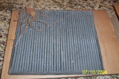

This is the filter

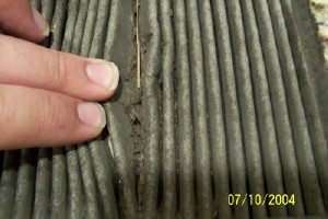

Close up, The picture does not give the total effect. It was clogged rather well and now the A/C works much better.

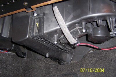

Passenger area below Glove compartment is where it is located. You need to remove the black cover with 2-7mm bolts.
07-10-2004, 07:51 PM
Location: Houston, TX
Posts: 348
The filter is located inside the door with the yellow stripe on it. There is an 8mm bolt at the front and follow the door down and another 8mm bolt to the right. remove these and the door does not come off but pivots down and you slide the filter out. Hope this helps all as I was amazed that no one knew about this from a dealers stand point. BIG-C I doubled checked my part number but still comfirm it with your dealer

Many, Many thanks T. Good pics and write up. Man, that thing was PLUGGED. I see you guys even have big dust spores in Texas  .
