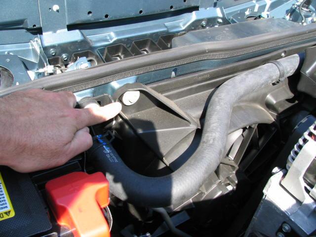

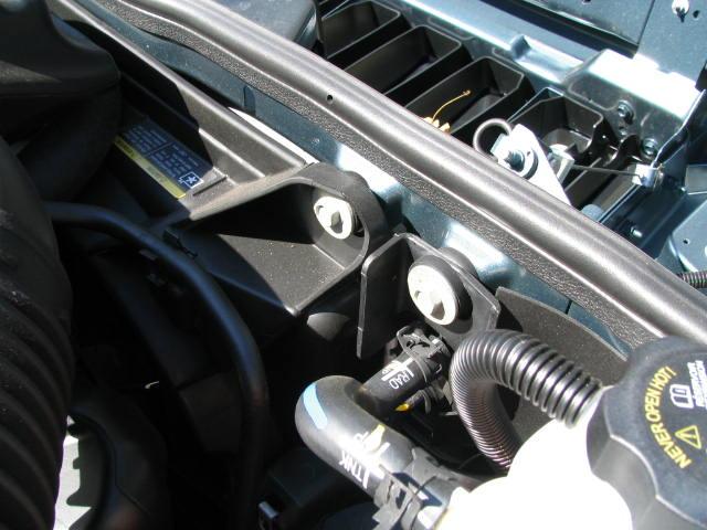

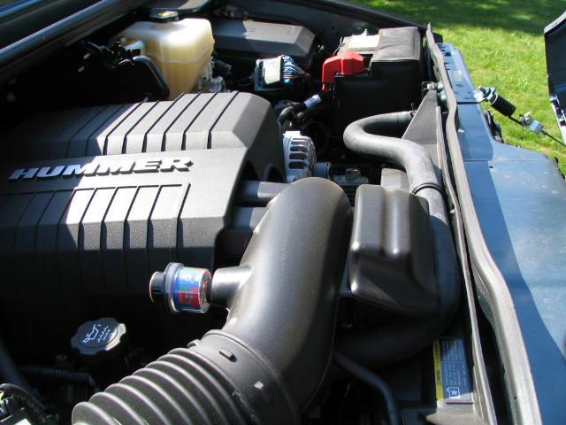

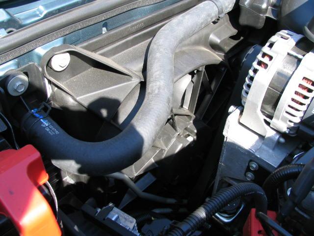

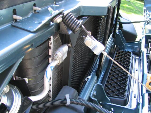

Can anyone confirm if the 08s have electric fans? If so, can you please post some pics and measurements between the fan shroud mounting bolts etc?

I'll look and see, but from what i recall reading they do have the electric fans on them. I've only had the hood open on my 08 once since I bought it.

Tomp,
here are the pics of the rad and the fan set up. Its kinda tight in there so not sure how well the pics will show the set up. It appears to me that the dual electric fans are mounted on a large plastic shroud. There are three radiators in total.
Hope these pics help you out.

From those angles, it almost looks like the tranny cooler in front is a little larger as well. If you get time, please post some measurements of the little tranny cooler in the front.
Thanks again Mike for your efforts! Much appreciated!

You are welcome. I'll get some dimensions on the front cooler for you. Hope those pics helped. Kinda hard to get any shots the way stuff is all jammed in there like it is.
This is highly unlikely. Probably a radiator, a tranny cooler and an oil cooler.
