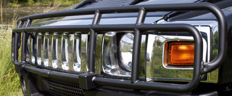

Notice the boxes below inside vertical 1 inch bars or light mountings. They are hollow from the bottom and made of 3/16" metal alloy steel. The boxes are on the standard brush guard also. Go to your friendly auto parts and Home Depot stores to purchas the parts listed below.

After putting wing nuts on first time, you can hand tighten wing nuts without a problem. Sorry I bought SMA Heavy Duty Brush Guard before taking picture of it. Mounting High Lift jack onto new guard, not none yet.

The old guard is at the dealers pile of junk. I took the mountings off of it and will mount to new SMA Heavy duty one. Will take a picture when its done. maybe this weekend. The mounting will look the same just with new guard. Anyway with my detailed description can't you picture it in your mind.

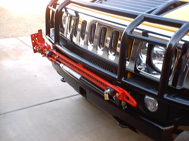

Hi lift on SMA Heavy Duty Brushgrard. I'm going to change the 48" to 60" monday. Got lots of room for the longer one.

Got the 60 inch on but one problem. the 60" has a different hole pattern from the 48" I had to move one of the holes over .25". now it fits fine.

looks nice. any rattle/noise when bouncing around? I wonder if the winch will fit with the jack in place. A great solution for those who don't want a roof-rack (me).

No rattle at all. mounted in 1.0" rubber on both sides. Rubber tighten aganst jack with 1/2" thumb screws. Make it as tight as you want.
