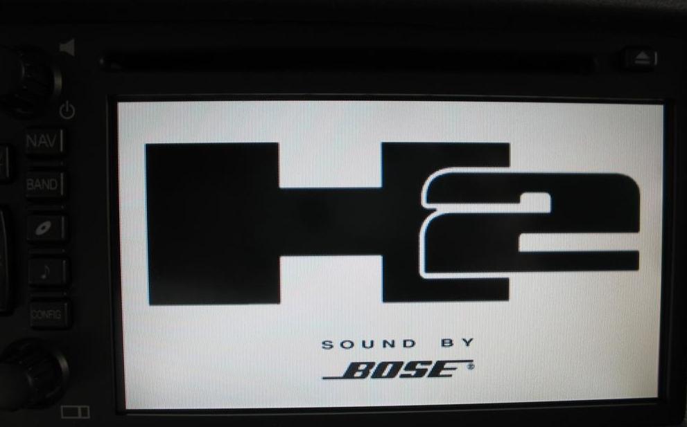

Bevo,
Do NOT buy part number 15120706 for your 2003 H2. That part number is for the 2005 (and possibly late 2004) H2s. I am working on this now.
The Bose amps were changed in mid 2004 to a lower grade model. 2003s have the "LUX" amp, just like the Cadillac Escalades. The later 2004s and the 2005s have the "premium" Bose system. You can tell the difference my the audio selections available on your radio. If your audio selections include "Normal, Driver, Rear, and Spacious" you have the "LUX" amp. If your selections include "Custom" you have the "premium" amp.
This is important, as the 2005 Hummer has the "premium" amp. The TNR for the "premium" amp vehicles appears to be different than for the "LUX" amp vehicles. Picking the wrong combination appears to not work (no audio).
The 2005 Escalade appears to have the TNR and "LUX" amp combination.

The INR is the 2004 NAV unit (Integrated Navigation Radio - what I have now).
The TNR is the 2005 NAV unit (Touchscreen Navigation Radio)

Klaus,
Saw your posts on the Avalanche site. I realize that you are in the process of verifying and I'll wait until you do. I do have a question about the Onstar XM antenna. Will it work with the new TNR HU and do we still have to purchase the GPS antenna? If it does work, what is the P# for it?:
So if I followed along, this would be the requisite P#'s if I wanted to do TNR and XM:
10377531
Power Radio Antenna Module
2004-2005 nav unit
12498768
Add on XM player for 2003-2004 trucks
10390370
DISC-NAVN DATA
15135178
Power Radio Antenna Module (GPS Antenna)
Also, are you aware of any GM multidisc CD players that are mp3 compatible that will work with this setup?
Yellow 03 Adventure w/black Grill, UM8 Touch Screen Navigation Radio, U2K XM Digital Radio, Remote 6-CD Changer, JBA Titanium Headers, Corsa Off-Road Sport, Airaid Filter & MIT, Nology Wires & Plugs, S&P Pro-Flash, Warn 9.5ti w/X-Line, Toyo Open Country M/T 37x13.5.
Old 10-31-2004, 02:25 PM
Klaus's Avatar
Klaus Klaus is offline
Location: CSA
Posts: 2,511
Bevo,
Those part numbers look good. HOWEVER - I have not done the TNR yet. No guarantees!
You still need to buy the GPS antenna for the NAV.
I can't recommend the 2005 antenna for XM. The wiring/connectors are completely different between the 2003 and 2005 H2s. Besides, the XM kit comes with an XM antenna. If your 2003 has a sunroof, you might want to use an aftermarket magnetic/stick-on XM antenna. They are not very expensive. The other option would be to buy and install the 2005 AM/FM antenna, and mount the antenna from the XM kit where the 2003 factory AM/FM antenna is located on the roof.
I'm not aware of any GM MP3 player, but they might exist.

I just ordered the TNR. I should have it by the end of the week, and if so, can install it this weekend.

Well, the TNR was delivered! They shipped it overnight.
Time to take the truck apart again this weekend!

Let me test it before I keep publishing the part number.
It was expensive, but still a little less than a used one recently sold for on ebay! And that one needed to be unlocked at a dealer. I bought mine from an ACDelco Distributor.
More info to follow...

The 2005 TNR Touchscreen Navigation works fine in my 2003.
