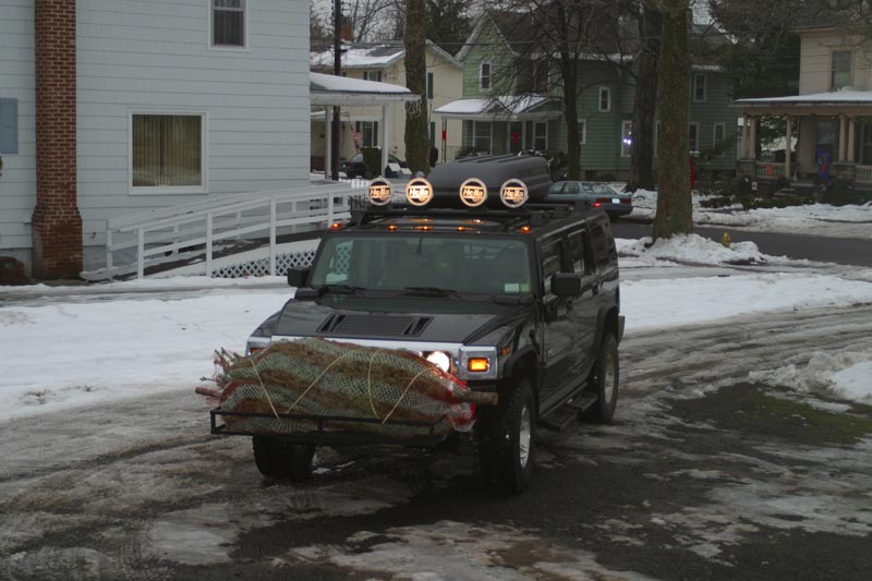

4 rallaye 4000 on top two center eurobeams two on side luminator fogs all with 100w replacements. having the luminators on the side really gives great side lighting for slow going. I have gone with non hid's on the top since I don't tie these to the high beam switch and use them mostly off road. This set up works great! As soon as SMA comes out with grill guard two 4000hid's will go there which will be switched into high beam switch. Have not decided yet on Cibie replacement or sylvania hid's with h1 high beam i want to hear some more input. I have replaced the bulbs on the factory lamps and don't waste your money the reflectors are so poor the high beam improvement even with 80/100 bulbs sucks.

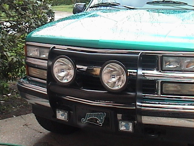

Old 12-14-2002, 04:51 PM
buddy buddy is offline
Location: Florida
Posts: 216
buddy is off the scale
and lots of it with the Hella 4000 Motorsport HID's. They are big and the ballast must be mounted very close to the light. A hard light to mount on the H2 with stock brush guards. I know I've tried.
Another excellent light is the KC lite HID's. They will mount on the stock brush guard.
Two of either brand will light more than 6 halogens. Expect to pay $1300-1500 for a set.
Below is a pic of the Hella's mounted on a Z-71.
They come in 2-tone black and red-orange..I painted them black. [img]/infopop/emoticons/icon_smile.gif[/img]
