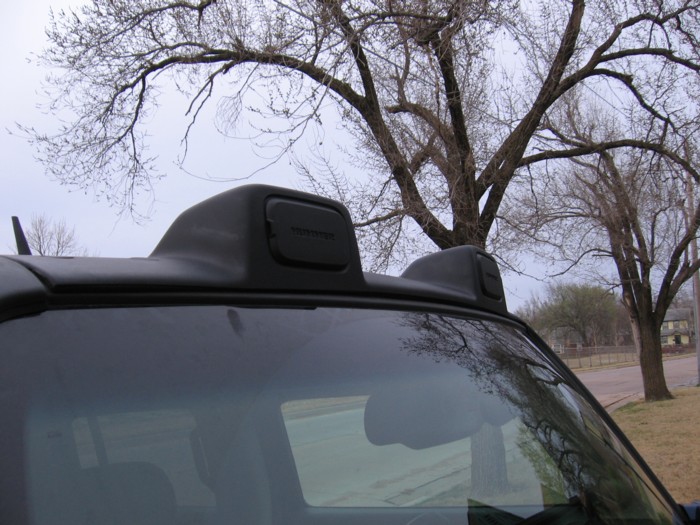

Well... Here is the Wind Noise fix I got from GM for the Off-Road/Marker lights. It did fix the noise but... oh yuck! The dealer that installed it is calling Hummer tomorrow to see what the heck is going on. The fix kit # they used is 19166037. The tech told me it just consisted of a couple of blocks in the middle to change the angle so it wouldn't make any noise, he also... on his own took it upon himself to put a rubber strip all along the front under the plastic .... and you can see how it makes the edges not flush with the pillar plastic. I can't beleive all this! But oh man look at the back! You can see the 2 blocks they put in there. I don't think I can except this fix at all!

2006 H3 Superior Blue, Adventure + Lux Pkg, Automatic, Sunroof, GPS, Rocker Protection, Black Brush Guard, Roof-mounted off road lamps, Trailer package, Underbody Protection, ROLA Roof Rack, and now Toyo 35's!
