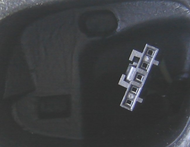

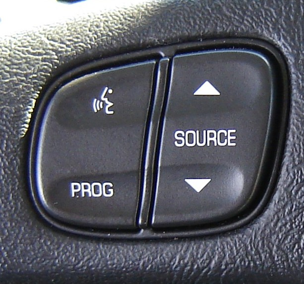

I recently had the same issue w/ 3 of my steering wheel controls on a 2004 H2. The light didn't work but the switch controls worked fine. I've attached a few pix, hope they help.
I don't believe that the bulbs in the switches can be replaced (but I'm not 100% sure). The whole switch needs to be replaced. The switch can be worked out of the hole it sits in without leaving any damage using a small screwdriver.
I had to use a type of "dental" tool to hold the connector in place while I plugged in the new switch. There wasn't enough slack on the wire to pull the connector all the way out of the hole (this was the hardest part).

They're LEDs not bulbs. Not designed to be replaced. However, if you have to replace the switch anyway; try it; you have nothing to lose. Chances are, the local radio shack will have the replacement LED for about 2 bucks, and a little time with a soldering iron might be fun.

Thanks for the pics. Ialways wondered how to get those out if the bulbs went out.

Hey Dolphin, thanks for the pics and instructions on how to replace the bulbs/buttons. Just from looking at the pics themselves, it does appear that the hardest part will be reconnecting the new button to the wiring harness in the steering wheel. I wonder why GM wouldn't have just put a little more slack in the wiring to make it easier? How much time do you think you spent trying to reconnect the button? I'm afraid I'll lose my patience during the whole process. Thanks again!!

After I got the switch out, I realized that I couldn't hold onto to the connector and plug the new switch back in (after about 10-15 minutes of trying).
The key to this (for me anyway), is to get some sort of tool that's skinny enough w/a hook on the end to carefully hold the back of the connector steady. That made plugging in the new switch possible. You may luck out & the wiring harness in your steering wheel may have more slack than mine did.
Once I had that "dental" tool to hold the connector, it took about 10 min. to do all three.
