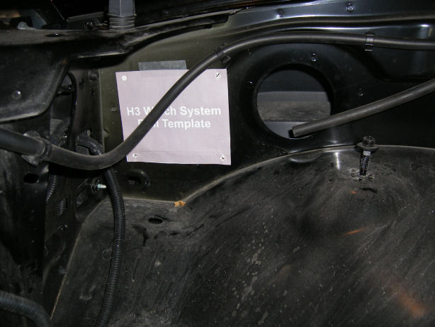

Inner Fender where the remote control box will be installed. The airbox has already been removed
http://www.elcovaforums.com/forums/attachment.php?attachmentid=34989&stc=1&d=11683090 37
Here is the template that is used to dril the holes that are used to mount the contro box. Note that you only have to use three of the holes. I also had to use a longer bolt in place of one of the factory bolts since I placed the box very far forward and there is a hump on the inner fender wall.
http://www.elcovaforums.com/forums/attachment.php?attachmentid=34990&stc=1&d=11683090 44

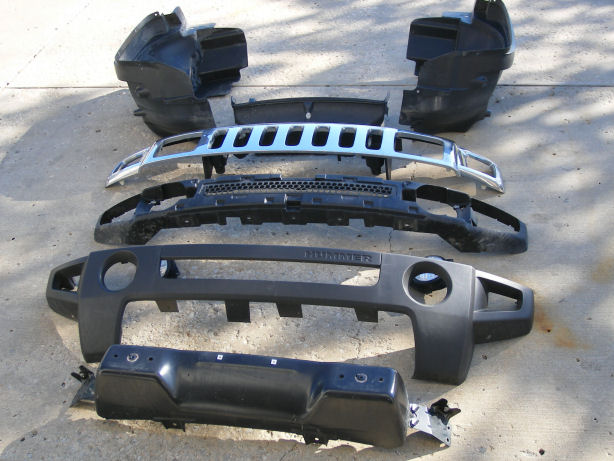

The disassemble is layed out on my driveway. There is also an air duct component that is in front of the radiator that will not be re-installed since there is no longer room for that part.
http://www.elcovaforums.com/forums/attachment.php?attachmentid=34992&stc=1&d=11683090 57
