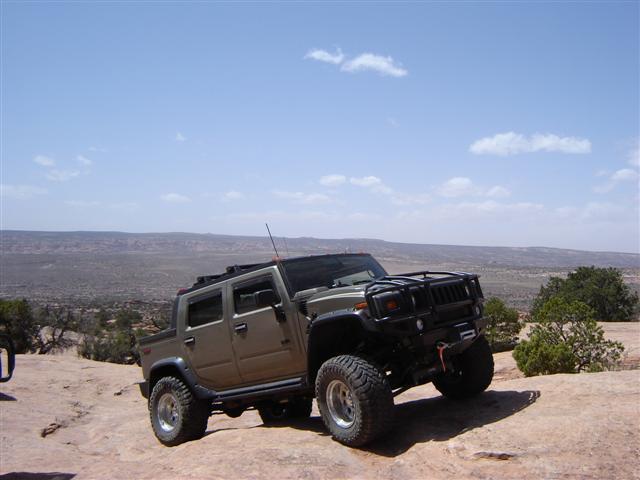

Default Re: To Lift or Not to Lift - Please help!
Love the lift, but wheeling it you will go thru some parts pretty quickly especially if you go with a 15.5" width.
Getting looks is very easy with it, too. Hell, I had to pry my wife out of it because it made her feel 17 again.
This is the same setup as Phil's.
