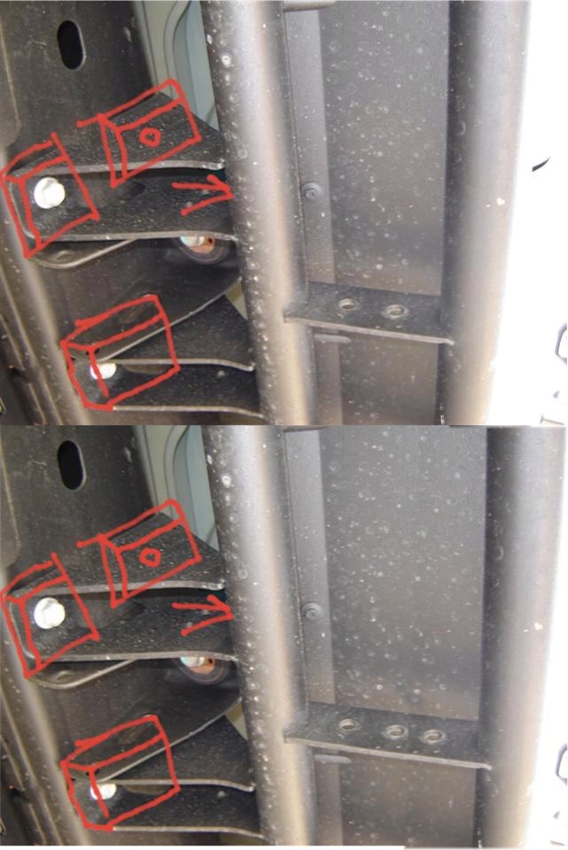

Has anyone ever tinkered with their rock rails?
I was checking them out today and though sturdy, the cross sections appear they might catch.
I was thinking that perhaps you could fabricate some extra protection on the bottom and extend them out a little, and the protrusion could negate the need for a step.
Any thoughts..

Leave the part that mounts to the frame and the inner rail alone. Cut the outer rail off at the horizontal mounts. Use some plate steel to extend the tabs so that the outer rail is sticking out the proper amount. Also add some extra tabs for extra support. </div></BLOCKQUOTE>That would work too, but I would have to take it off anyway and the spacers would be quick, even and easy.
I have to use one for each bolt though because the driver's side has a wire and the fuel filter box (I think). </div></BLOCKQUOTE>I am not fond of the blocks idea. Can't pinpoint why off the top of my head. Just doesn't "feel" right.
Another idea is to cut the outer rails off from the tabs and get some custom outer rails made up by a metal shop. You could then bolt them back to the tabs using the holes the steps bolt to.

But I could only do it about an inch unless I want to start cutting- and that's not going to happen. The extension should protrude it enough for the ball of a foot or something.
I am also looking into creating something to extend off the rails to protect the torsion bars.

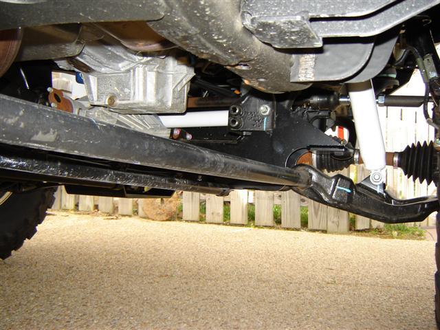

Para, why must it rotate? I was thinking more like what CP described -- a stationary "ramp" with the pallet wheels in them, to glide-over and pick-up the rear diff over the rock (with a little momemtum). </div></BLOCKQUOTE>Well, my first reaction would be durability. Having some types of small wheels mean that there would be some small axles. Conceiveably, half the weight of the truck could come to rest on one of the wheels. Also, ground rock and debri would gather up and around the wheel.
My reasoning behind something moving was the same idea as the wheel. To reduce friction. The idea that was in my head had a "foot" that was flat on bottom but rounded up to vertical. When contacting the rock the movement would allow frictionless travel over the rock until the "plate" hit a stop. Then it acts as an ordinary skid plate and will drag the rest of the way. But this will help keep the rear end from hanging up and probably further help you to high-center on the rear end.
In my rambling thoughts about our UCP I often wonder if the best solution would not be a network of front-to-back I-Beam shaped pieces tied together horizontally for twisting stability. I don't know of any stock metal that could be used, though. It would have to be some custom extrusion, I would guess.
The pieces could be bolted together so that when you destroy one or two sections, you could easily buy the individual lengths and replace only what was need. Obviously, once it was damaged, there wouldn't be any straightening it or anything.
Actually, with further thought it could be a modular thing and applicable to any vehicle
