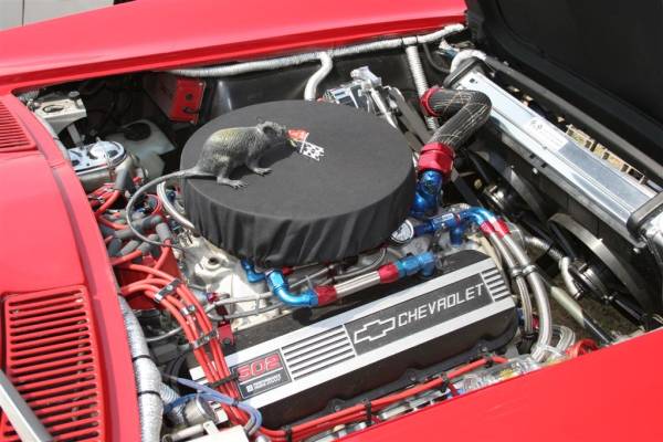

Nope...not trying to steal it ..here's the rig...2 days old ..less the marker lamps

I like the Panty Dropper next to your hummer, Is that a fuelie?
Nice.

Fulie....Nah.. Don't want no sting-en Fulie... It's a ZZ502 BB with A Barry Grant Toilet Flusher...
