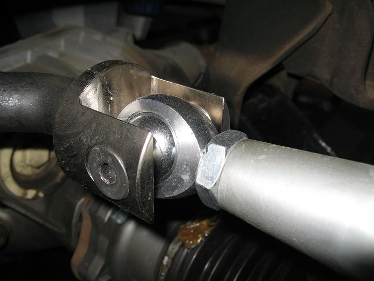

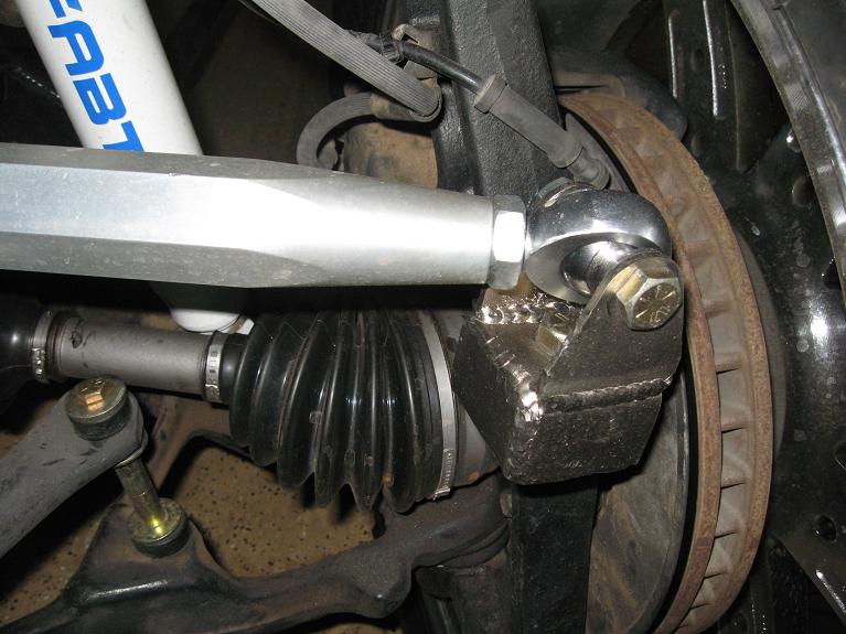

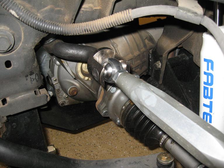

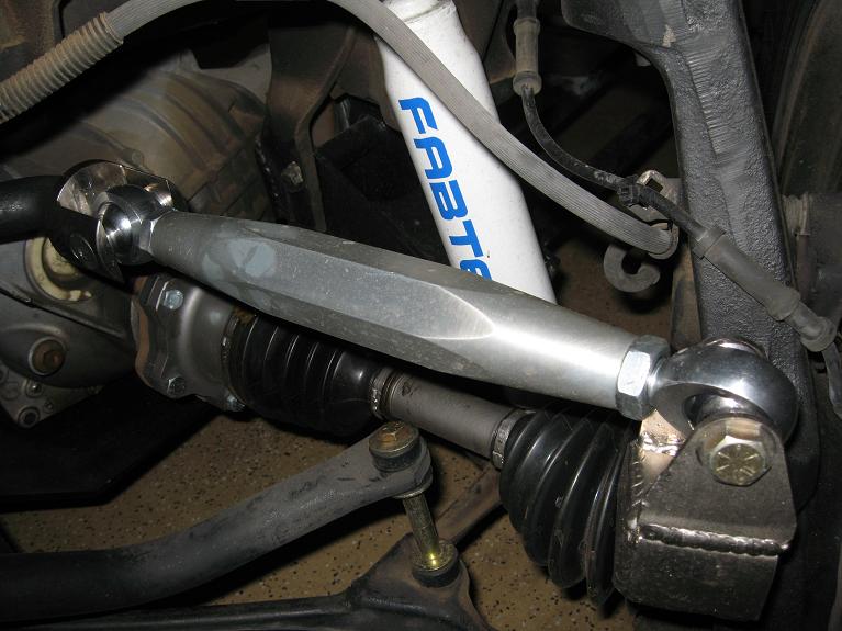

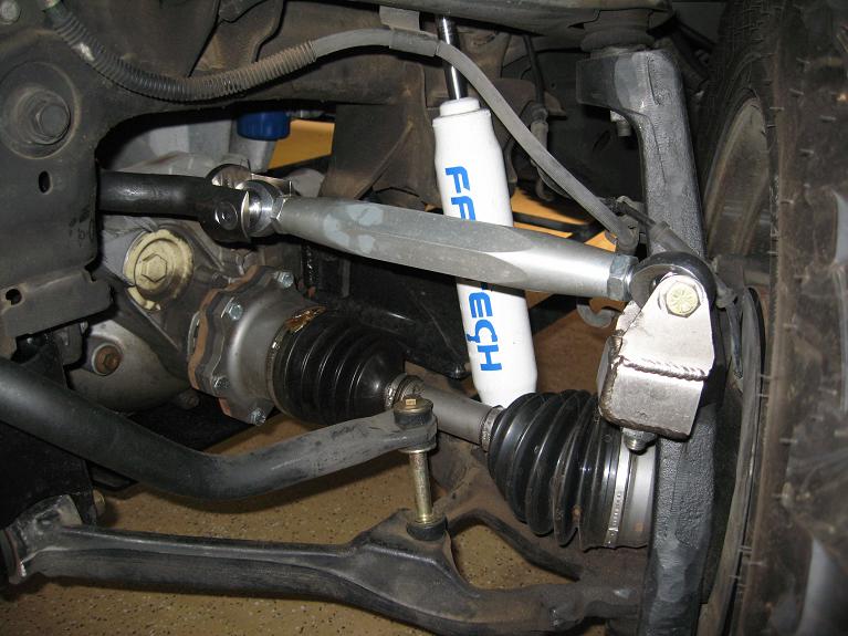

Thanks for all the help guys! I was going to order the Fabtech tie-rods, then the dealer suggested these. When I first saw these, I was impressed! When I asked what brand these were they said they were custom made. Anybody recognize them?

I've never seen anything like those, but they look beefy and sturdy! I like it a lot.

I have got to get a set of those!!!!!!!! Post up some contact info for those and also a price. Pleaseeeeeeeeeee

Whoa searched on line and found these!!!!
http://bulletproofsteering.com/gmifstierod.html

I am considering just buying all the parts and making my own set? Looks simple enough. Some spherical ends a couple of bolts and what looks like a sway bar end link???
