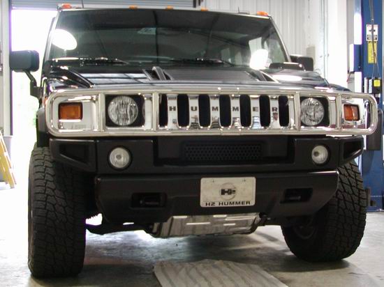

Here are a few pics of a skid plate that did the honorable thing. (It took one for the team)

Hammered out and a little left to go.

Scratches-n-Dents are history (as was his-story). Off to polishing.

The finished product.

Whadd'ya think??

This poor skid plate took a beating (inside &out)!

Near 100% recovery.

What happens when the crome gets dented???

I don't think that is chrome. Bright just polishes up the steel to a nice shine.

Oh don’t be… sorry is the guy who paid 500$ to exchange his for a chrome one!!

The skid plate in the above pictures was repaired at no additional cost.
Polishing = 165$
Return shipping = 25$
Optional Extreme polish & sealer (for maintenance)= 25$

Keep an eye out for a new topic regarding chrome over aluminum. But very briefly, chrome is brittle and thin and therefore will not flex or bend with the aluminum which is a relatively soft metal. So if dented, cracking and flaking is immediate. The cost of doing a revision on chrome is very expensive because there is no such thing as a "touch up" with chrome....it's "all or none". The above pictured skid plate was about to be replaced with a new, unpolished one for the cost of 350$ (at least, that is what my dealer wanted to charge me). Instead it was repaired and polished to a mirror finish for about half the price of the new one. I hear some dealers are charging 500$ for a chrome exchange.In my next topic, I will go into depth why I feel polishing is better than chrome on aluminum (p.s. I started out in the chrome plating industry)
