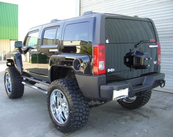

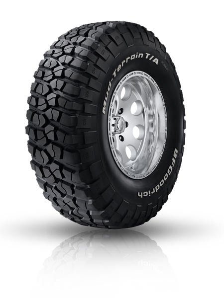

Can anyone tell me the difference between these two tires? I'm probably going with a 22x12 wheel and would like these since they come in a 335/55/22.. My question is that the pic of the KM2 on their site shows more siping ... I've included a few pics from other hummer owners and their KM2's look different?? Can anyone explain? Also, I'm trying to figure out if this setup will fit without a lift? The overall diameter is 36.5 but the width is 13.2

I just got 5 37x12.50 17 and they do not have the siping in the middle 2 blocks of tread. I do think they are great tires though just not for ice. Very low increase in hum over the stock T/A's.

I have the KM2's and they don't look anything like the last picture!

anyways, there are 2 versions of these tires from what i understand.
the first version, and the KM2.. they might both be KM2 actually, but still there are 2 versions. one is old, and the other is new.
i run the new version which looks like the ones in your last pic.
im running stock suspension. only T bars cranked a little.
even with the 12.5 width, there will be some rubbing on the front end on the rear of the wheel well. just trim the plastic molding, and all is good.

also, if you look at my first pic and the last one, you will see the difference at the very bottom where i trimed down the plastic on the rear of the fender well.
