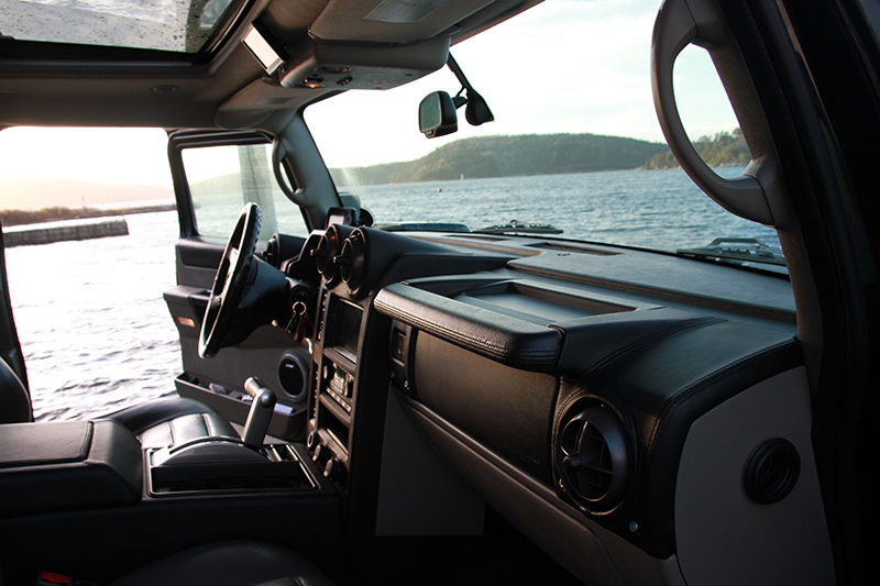

Hi guys
Im currently upgrading the look of the interior of my 2004 H2.
Just got the center console and the mid console (dont know what its called, the one that covers the stereo and ac) in leather, looks awesome in my eyes.
Now i need to get the other parts done in the front, left side vent (gray plastic now) and the right side vent and the other one on the right side where the airbag switch is.
Problem is, how do I safely remove these parts without screwing up the airbag and anything else. I removed the bolts (4 in total) but its still stuck.
Any tips ?
PzYkED

The driver side vent has the 2 bolts then it just pops off. It can be pretty difficult to remove but it will come free.
The passenger side, you need to remove the handle. Remove the small trim piece on the side of the dash where the door closes then you need to use a long screwdriver to push the small buttons under the dash to unlock the handle. You have to keep the damn buttons pressed while wiggling the handle out. I've had mine off a number of times and every time it is a royal PITA!
Good luck!

Thx LoJac Got em off and now leather covered, will post pictures soon

Better late than never

That turned out really good.
