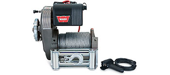

Yeah... it got pretty involved before I got through. That is a M8274 Warn which I already had and it has it's own dedicated battery mounted along side it. The power cables are only 18" long 2ga. so it does't experience much voltage drop during heavy pulls. I pulled battery charging voltage from the trailer recptacle. I built a whole new receiver and winch mount for the project.

that does look pretty involved.... for me... I will grab a friend and carry the winch to the rear... but if i were to do it all over again.... that would be pretty tight

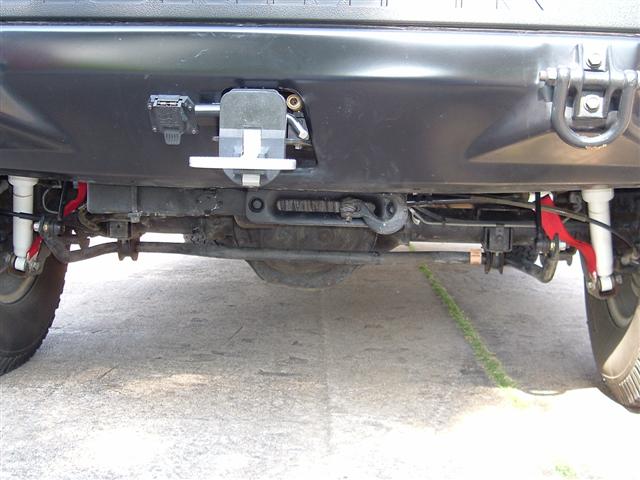

Here is where I mounted my air quick connect next to the hitch reciever. You are right about sand getting in there, I use a small screwdriver to depress the center plunger and blow the dirt out before hooking up the air hose. So far dirt hasn't been a problem (after about 8 months use), I do wash it with the pressure washer when I wash the H2 though and spray a little WD40 on it.
BTW departure angle isn't a problem as my winch fairlead hasn't hit, but notice the drag marks on the right "D" ring.

nice install.. I found that sand also gummed up the retractable part of the quick connect.. I dont wash my truck too often so that probably nailed me.
got any pics of underneath on how the winch is installed.. that looks pretty tight but dont know what you mounted to with ease without making some big mods...
