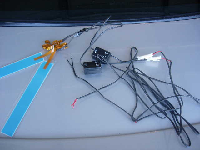

Skylo -- What came in the kit? Any chance you can post photos of all parts? With that and the schematic we may be able to figure it out.
Couple questions I have: Is the microswitch on the schematic the truck's existing switch or is it a switch that's built-in the sill? How big is the inverter and is it a separate box that mounts remotely from the sill?

1. The microswitch is refering to the switch on the truck(somewhere).
2. The invertor is small and is wired into the lights (wiring looks pretty simple) themselves.
I think the pics might help and I will get them up as soon as I can.

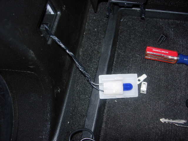

Ok, Here is a pic. It looks simple but maybe someone with wiring experience can tell me which wire to connect these two (2 red/ 2 black). I am not into chopping the wiring on my $50,000+ truck...FYI, the wire schematic is on pg 1 of this post.
Thanks

Hmmm. I see two white plugs, each with a red and a black wire. But at the end of the wire pairs, I see one set of black and one set of red.
Do the wires change color in the wrapping or do the wires get switched somewhere so that the reds and blacks end up together?

The wires get switched inside the coverings. I think I can just put both blks on the same connection and the same with the reds.
I can't believe No one knows which wires I can hook these too. I took taz advice and found the wires to a kick light which is activated only when I open the door but I dont know which wires (red or blk) to hook up to the light wires (blk or blkw white stripe).
The red only needs a "hot" source(only when doors are opened) and the blk needs to go to a ground. The clips are just for a quick disconnect.
Does anyone know how to test the car light wires to see which one is hot and the ground?

1. Here are the wires with the kit. Also don't forget to turn off the dome lights using the switch next to the headlight switch( this will make the wires you are working with "dead" so you don't get shocked or short out anything).

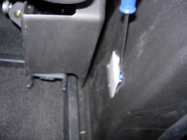

2. Locate the kick panel light which is behind the driver/passenger seat repectively. Pop the cover off using a small bladed flat head screwdriver (from the top is easiest).
3. This is what it looks like with the light opened, exposing the 2 wires needed for wiring.

5. Now cut and wire together the lights (the vehicles grey wire goes to the red wires of the sill lights and the black wire to the black wires of the sill lights) Don't forget to hook the kick panel light up with everything else.
6. I am old fashioned and used solder to connect my wires but you can use any type clip you like.
7. Next put the converter boxes under each door sill along with excess wires. The rear sill only needs to opened alittle bit to place the wires/boxes under them.
