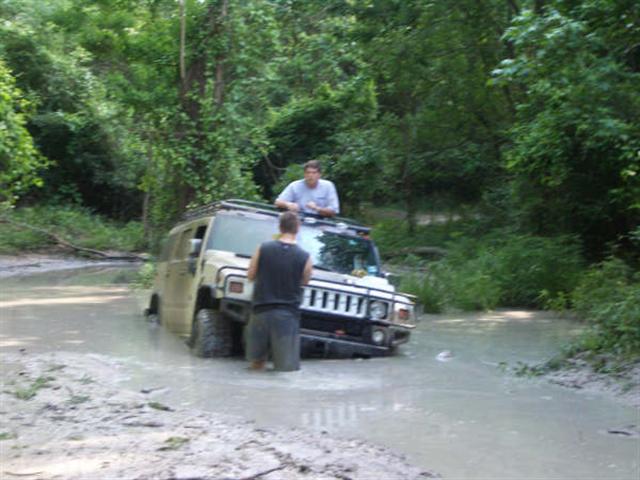

Keep having to replace my Evap Canister and purge valve due to mud @ local walmart.
Anyone have a fix for this problem. Yes I know I should avoid deep mud holes, but my steering box heads for the deepest spot everytime

Like this

Like this
Don't replace it, just clean it out really well!
