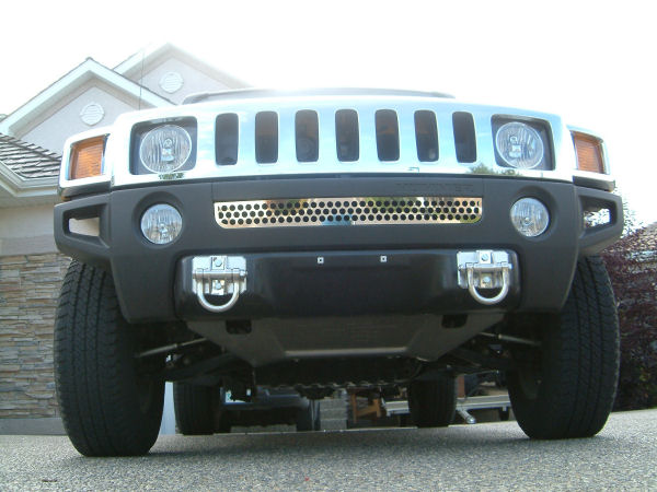

Well, okay not chrome....actually stainless steel, but nonetheless a whole lot better than those stock hooks.
You would think that this would be a simple job, well thanks to GM they made what should be a cake walk a little more time consuming. On with the pics!!
First the tow hooks have to come off....
So now what's holding the brackets on?!?!?!?
Well lets take some pieces off and see what is making this little suckers stay on.........
First the front chrome grille has to come off.....6 small little bolts and off it comes!
Nope, still not there......time to take off the skid plate!
Nope, still not gonna do it.....why not the whole front bumper!!!!!!
So what held these little brackets on you ask?? Well I am certain the brain work of GM with placing two USELESS 10mm bolts on the backside of the front bumper which can only be accessed by taking the whole front end off must have been placed there by some cruel joke I am unaware of....
Well after that little hassle......here's the after shots.......
And on to the back hook....must have been a better day for the guys at GM. They neglected that little extra bolt on the back hook!!!
And finally....... a couple front shots with the lower chrome grille added in for an added touch!

Actually the install wasn't that bad at all. For the full install, including me taking pictures at every step and then the reassembly it didn't take more than 1 1\2 hours. I could do it again in probably 30 mins now that I know where all the bolts are located. RealWheels instructions for the tow hooks were actually really really well laid out and made the job pretty much hassle free!

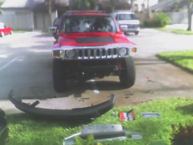

I went through that crap to install the brush guard! What is the purpose of the little scwews behind the hooks? I was told it was a 30 min job, it took me 6 hours!!! see my pics...

On those two bolts holding the tow hooks to the bumper, my guess would be that the tow hook are sub-assembled to the bumper before being attached to the truck for easyier/quicker assembly in the plant.
