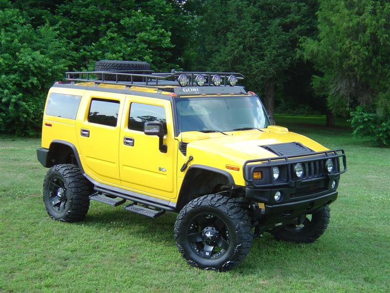

block is that stock or did you add a lift, im putting that same rim but with a bfg mt km2 instead of a nitto
Old 09-18-2007, 06:22 PM
Hucky Hucky is offline
Join Date: Aug 2007
Posts: 324
Hucky is on a distinguished road
Default Re: Confused
Blocks is lifted, look at the front of his Rig you can see the Square Raised Block under his H2 aluminum skid plate, Im guessing hes 4 inches on a Rancho?
Old 09-18-2007, 06:26 PM
I believe he has a 6", but I could be wrong.
Old 09-18-2007, 06:30 PM
Posts: 395
hi , yeah its a 6 inch fabtech lift !
