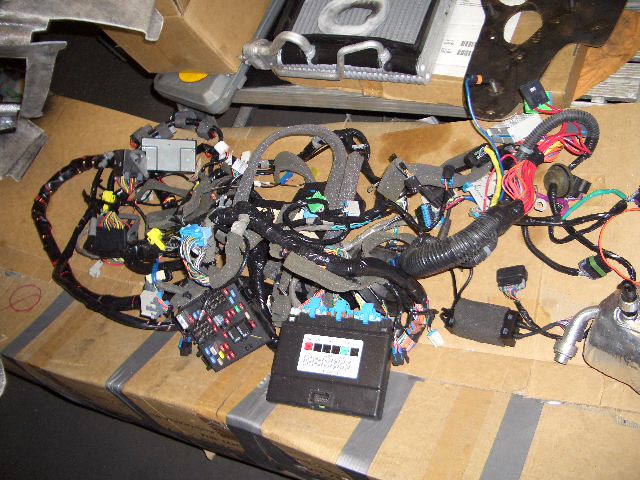

PS here are some pics of a new h2 cut up
