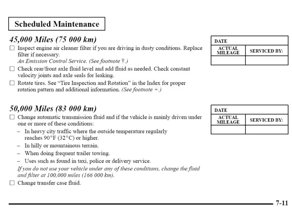

Old 04-07-2006, 06:37 PM
from the owner's manual

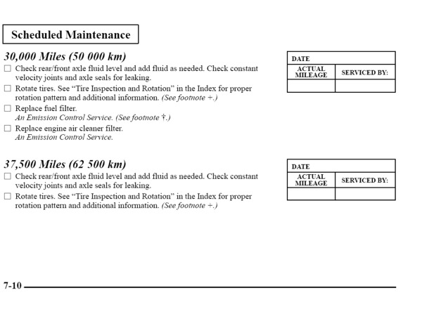

Old 04-07-2006, 06:39 PM
30K one

I'd say $1,400 is a good value for checking/adding axle fluid, rotating tires, and replacing the fuel and air filters. I paid $20k for someone to rotate my tires alone once.

I'd say 2 hours at 100/hour= $200 to do the service at a dealer.
Parts may be $100, so call it $300 total.
No fluid change necessary.

Make sure they're not trying to sell you some kind of injector flush/trans flush/power steering fluid conditioner type snake oil combination of services. If you read all the fine print at the back of the 'periodic checks and services' section of the owner's manual and have them done, the MOST you should pay is $750-$800.

Rich , Do it yourself. About $50. for air filter, and $20. for fuel filter. You can do these during a commercial instead of heading to the fridge. And i know you can rotate the tires. If you need step by step help, you can get it here. But dont give someone $1400. For 1hours work. Doug

By the way--in 2004 models GM moved the fuel filter into the fuel tank(don't replace usually)
