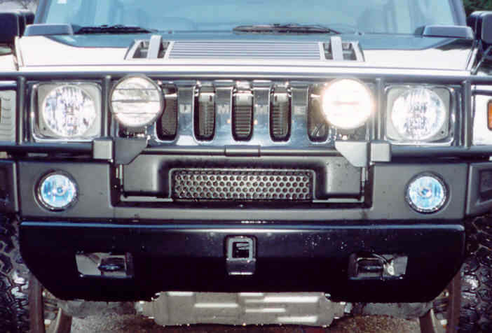

I made some preliminary review of the Hummer grill connections and realized it is a pretty simple and straight forward operation to remove and install grill, and the disconnection of the factory offroad lights should be snappy since the hook ups look like modula plugs.
However, I am a bit puzzled by the brush guard connections. There seems to be only 2 connecting points I can see, both are located behind and under those square boxes on the guard. Seems rather weak supported at 2 points only.
1- Are those the only 2 connecting points to the vehicle?
2- Do I take off the guard leaving the receiving brackets(or plates) attached to the vehicle? if I do not put the guard back on, those 2 little plates will be sticking out a little, right under the grill.
I found the Hummer offroad lamp covers which I never used, once I have the black grill on, I will cover these offorad lamps, paint the skip plate, I basically will have it all black up front, with the exception of the head/DRL lamps.

Mac,
The grill guard is also connected to the hood behind your off-road lights. There are 2 arms that extend behind the grill and is accessible when you open the hood.
John

Paragon,
I think you are incorrect. The wrap around grill has the two "extra" support arms that go behind the grill.
Mac has the standard grill that uses only one connection point .
Mac, there are bolts behind the lower grill assemply which simply pulls off.
Once you pul off the lower grill assembly you will see the bolts that hold on the grill.

The standard grill has 2 points connecting to the front, they are both located under those 2 square boxes on the lower central part of brush guard. From what I can see, should be easy, I estimate 1 to 2 hours job, including smoking breaks every 15 minutes. I am not very good merchanically speaking, except I can take apart and put together guns blindfolded in record speed.
I got it home from my office where it was shipped to. Either the grill is too long or the back of the Hummer is too short even with the back seats folded, but barely managed at 45 degrees. If the rain clears up tomorrow, I'll be working on it. It is beautiful, shiny black and flawless, light weight.

Mac,
You missed my point. By ONE connection point, I meant in one area...i.e. behind the lower grill. The wrap around model has two additional supports that attach from under the hood. You have to open the hood to get to them.
TO CLARIFY:
You should have 4 bolts behind the front lower grill that removes by gently pulling...

I was out there for half a hour figuring this thing out.
1- The first I must do is to remove the plastic mesh (round holes) center cover, that's the piece between DRLs and under the grill.
2- It is held on by the 5 or more plastic clips.
3- I tried clamp on the clip to push it out, that didn't work.
4- I tried pull it out but fear I might break the plastic retaining clips.
5- To pull it, the hood is closed, 2nd person can't see the back of clips. If the hood is open where one can see the clip, you can't pull it.
6- So how do you pull that piece of plastic out? I can measure and mark the clip spots. Just pull?
a- I see the guard is bolted on by 2 big screws to each hood hinge, I can get to them if I remove the center plastic cover.
b- Offroad lights can be pulled in 1 second.
c- The grill is the easy part, held on by 4 screws.
Thanks.

Old 12-13-2003, 05:58 PM
Patriot Patriot is offline
Posts: 318
Patriot is off the scale
Not to sound cross but CAN'T YOU READ??
I described it twice now...JUST PULL THE DAMN THING OFF!!
The front lower grill JUST PULLS OFF....GENTLY
I SAY AGAIN...IT JUST PULLS OFF.
I had mine off numerous times by JUST PULLING IT OFF!!!
I'd try JUST PULLING IT OFF....
