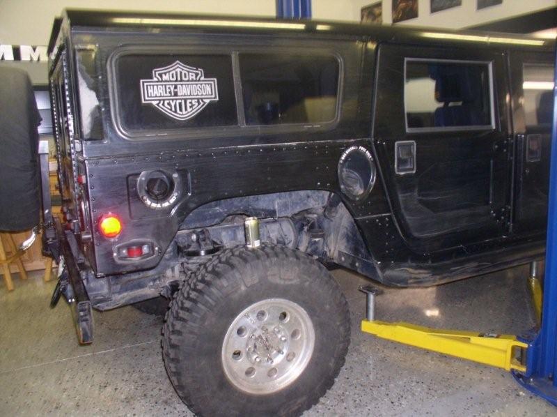

Harely Dave, you haven't broken anything yet because you haven't been off-road since you had it installed. Ok, maybe you did a little, but not enough!!
FYI - I just got done having the Alpha rear close out pannel installed after a 2" body lift. It does not fit exactly. It had to be trimmed quit a bit around the mid section. Looks pretty good though.
Ha! Since the lift, 3 trips to Moab and also Las Cruces Chile Challenge(where I did break a ujoint) is not enough? You're a hard woman to please!
Seriously though, I am currently gathering materials for a rear winch setup, rock ram, center the front diff, 12k brakes and axles, and 3.08 gears. I plan on making it out east next year for Kinslow and/or Windrock, depending on schedule. I'll probably make the post EJS Moab trip as well.
On the Alpha closeout, I thought about doing that as well but will probably end up raising the rear bumper instead for a better departure angle.

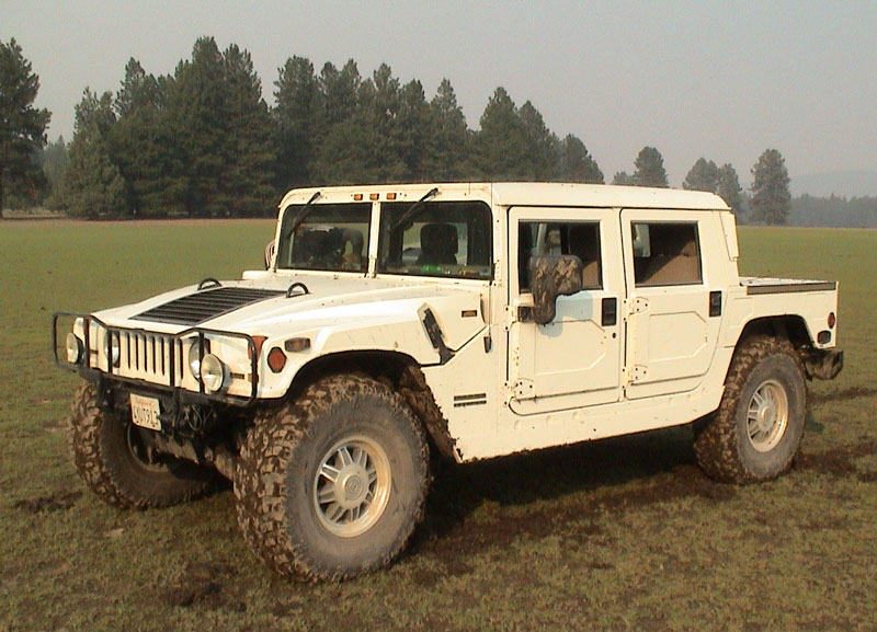

Old 04-19-2008, 05:36 PM
Default Re: Lift kit
Here's an '02 with 39's and no lift. It never rubbed.
Old 04-25-2008, 08:55 PM
You know, those are the perfect fit, but I really don't want to run IROKS on my long trips.....I love them in the mud and I saw how good they were on the Rubicon, but the noise and the wear for hi-way driving would drive me CRAZY!
That's a cool pic tho. I like those 4door hartops.
