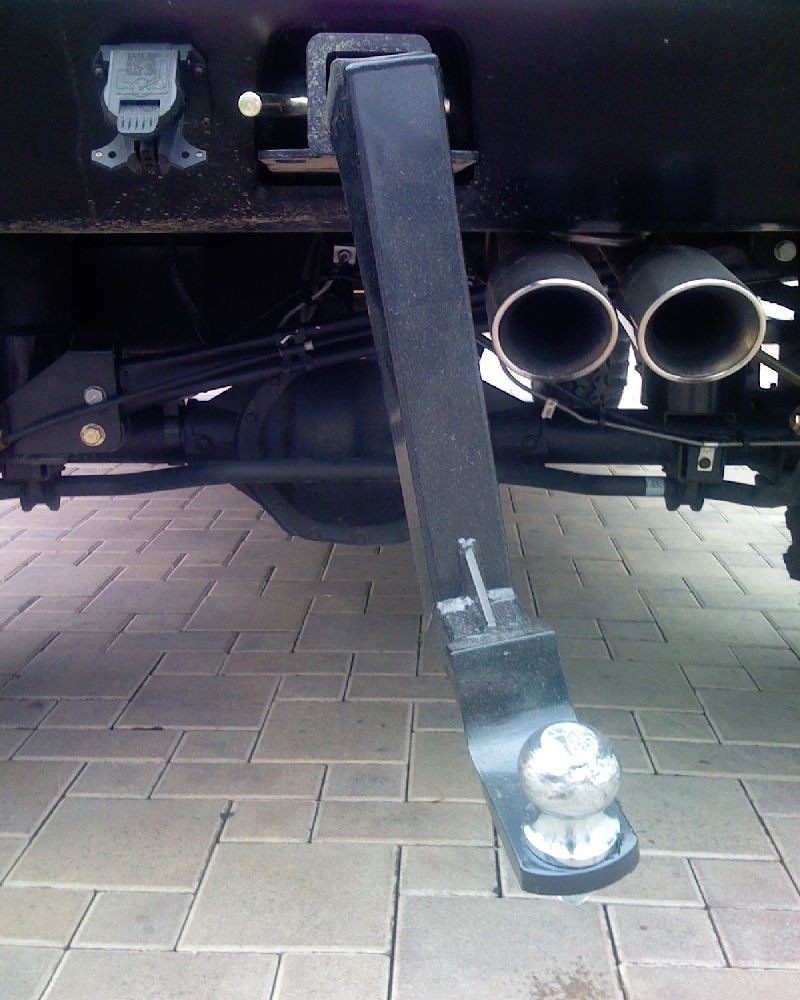

I had a 16" drop hitch made so I could tow my boat. Today I was backing it up and my trailer brakes locked up and the hitch buckled under the pressure. This is a warning to everone, make sure your hitch can handle the load!!

I've had that same concern in trying to find the ""correct" way to bring the hitch into a usable range.
http://search.express.ebay.com/merch...fab_W0QQ_dmdZ1
I've been thinking about a regular 8 or 10 in drop and using one of these to lower it the rest of the way.
Comments/thoughts welcome...

What a horrible design!

2of4, that hitch is only a 10" drop. I need a 16" drop

Anyway that is alot of leverage at 16inches of drop. I have an 8 inch drop. I really think that trailer needs a lift kit and some mudders to make it HUMMER worthy! lol

You might need to talk with an engineer since you are creating one heck of a load on that drop hitch and get one designed for the specific loading of your boat.
Wasnt it Archemedes that said....give me a long enough lever and I'll move the earth?

I have had a new hitch made out of thicker steel and had no problems. Thanks for all the help
