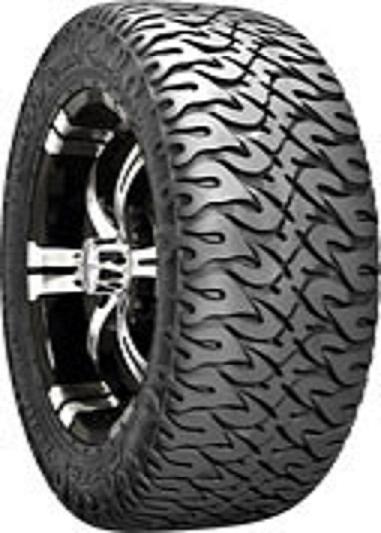

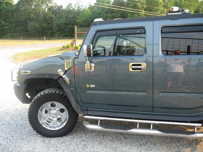

My next upgrade I want is a little taller tire. I'm presently running PRO-COMP XTREME a/t 33" x 13.50 on 18" MC2 rims. (They came on the truck when I bought it)
I'm happy with the style of the rims and width of the tire but think the 33" height make them look like I'm riding on "donuts". I was considering going with 37" NITTO DUNE GRAPPLER's. Has anyone put these on 18" rims? Is there any difference between putting 37" tires on 20" rims and 18" rims? Would they both have equal amount of rub if any?
Thanks for any help.

ive heard the dune grapplers suck,good on the sand though,no sipes,clog up in mud,bad on wet pavement,maybe someone out there is running them,and will let you know.

As far as tires I like the look of the sidewall of the NITTO DUNE GRAPPLER but it sounds like the preformance sucks. I may go with another set of PROCOMP XTREME AT's in 35"s or 37"s. I like the wide stance of the 13.5" width but not sure if 37" x 13.50" would create a major problem on 18" rims.

I'm on my second set of 37x13.5s on 18s with no problems whatsoever....better looking than 20s too, imo. If you get some rubbing, just crank the torsion bars up a bit, and get it realigned.

Hey im from south louisiana. Im running 37x12.5 on a 20 and i love them. I do get rub on hard turns i would imagine a 13.5 would rub alot.

I did 37's on 20's with some negative backspacing. ) rubbing with the 13.5.
I also ran Kumhos - was very impressed in all areas
I ran procomps for years on my expedition 35s - I would by the Kumhos again.
