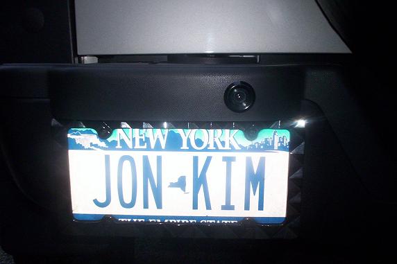

I think the best spot is in the middle (trailer hitch ).I do not have a hitch so I mounted it in the licence plate overhang.This works well and it is protected from off roading.

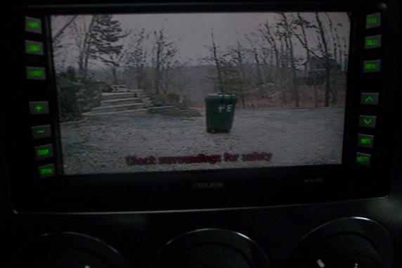

Pic of can 10 feet back from bumper

I have a trailer hitch and there is a steel bar behind the bumper in the section you speak of it is part of the hitch assembly. The bumper is platic in that spot but getting through the hitch bar behind it is where I'm stuck. A center mount camera would be nice but where to put it? I think I'm going to put it where 442 has it, tommorow. Hey 442 can you see the blind spot on the passenger side well with your mount?

If you noticed you cant see the spare.Look at the other pics I have listed ,the pic thats 1 foot away 4 inches from tire will give you an idea.The further away the object the more center it is.When I bring it up driving it seems centered to trafic I guess its because im sitting off center to begin with.eclipse dvd/nav rear camera
